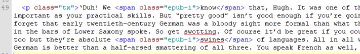

As for simple plurals snd posessives, they should in fact be added to the wordlist corpus. When affix compressed (munched) the plurals are properly detected and the suffixes are stripped and replaced with a flag hich keeps the root word list (.dic) small but word coverage large. That is the whole point of affix compression.
That is what I would have expected, but not what I experience in practice -
as you can see from these screen shots.
The word 'swines' has been highlighted as misspelled.
Removing the 's' corrects the problem
But (as you can see) swines is the valid plural of swine.
Do please do generate your UK wordlist (no need to check each one) we can do that via scowl. Include all variations of the word you have encountered.
We can fix the en based dictionaries.
OK, I will upload it later.

In common US English, the plural form of "swine" is in fact "swine" not "swines". I would guess your online dictionary is not quite correct in regards to this particular word, especially for US english.
But this may also be a point of divergence between GB vs US based dictionaries.

Just going back a few posts to my example of how removing the 's' affects the spellchecker, and we debated the use of swine vs swines as a plural. I was thinking further about this and it is all dependant on how you use the word swine.
1. Swine as a pig: In that situation I would use swine as the plural - 'a herd of swine'.
2. Swine as in a person behaving badly: In that situation I would use swines - 'you bunch of swines!'
Anyway I really had not intend it to become this complicated. I thought that it would have just been a simple matter of just adding some new words to the default dictionary. If it is going to take a lot of work then forget the whole thing, and we can just carry on using our user-defined dictionaries.
