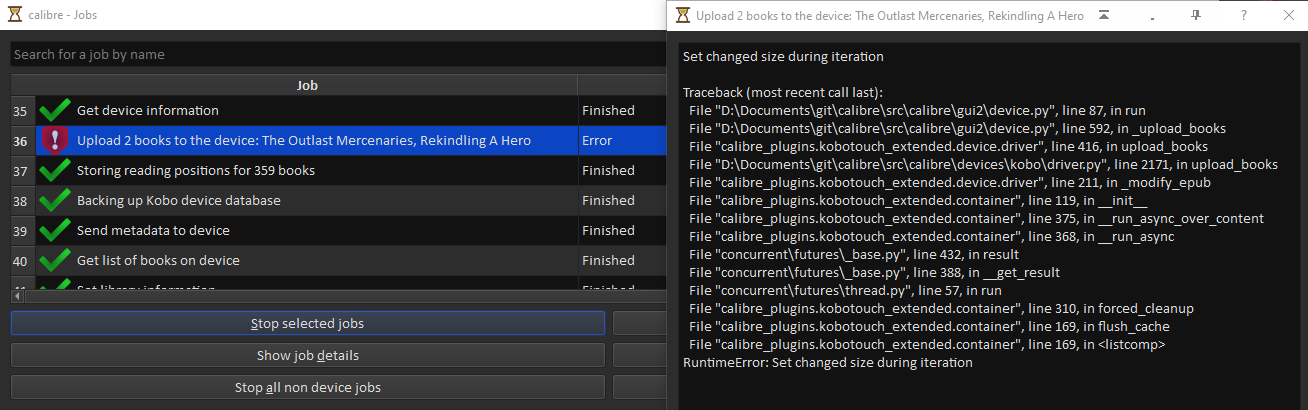

What does this mean? I got it when reading list tried to upload two books (both fanfics to be updated) to the device:
calibre, version 5.36.0
ERROR: Error: Error communicating with device
Set changed size during iteration
  File "D:\Documents\git\calibre\src\calibre\gui2\device.py", line 87, in run
  File "D:\Documents\git\calibre\src\calibre\gui2\device.py", line 592, in _upload_books
  File "calibre_plugins.kobotouch_extended.device.driver", line 416, in upload_books
  File "D:\Documents\git\calibre\src\calibre\devices\kobo\driver.py", line 2171, in upload_books
  File "calibre_plugins.kobotouch_extended.device.driver", line 211, in _modify_epub
  File "calibre_plugins.kobotouch_extended.container", line 119, in __init__
  File "calibre_plugins.kobotouch_extended.container", line 375, in __run_async_over_content
  File "calibre_plugins.kobotouch_extended.container", line 368, in __run_async
  File "concurrent\futures\_base.py", line 432, in result
  File "concurrent\futures\_base.py", line 388, in __get_result
  File "concurrent\futures\thread.py", line 57, in run
  File "calibre_plugins.kobotouch_extended.container", line 310, in forced_cleanup
  File "calibre_plugins.kobotouch_extended.container", line 169, in flush_cache
  File "calibre_plugins.kobotouch_extended.container", line 169, in <listcomp>
RuntimeError: Set changed size during iteration
I didn't run into any more issues, and sending them manually worked.
Looking at the code, I can see what is happening, and, in one way, I'm not that surprised. But, it usually works and I can't think of a reason that sending multiple books would trigger an error when sending a single book doesn't. I'll have to think about it. Or hope Joel notices and pops in.

The only thing I can think of out of the ordinary is that one of the books I'd accidentally added to the send-to-device list twice. But the Calibre job manager didn't indicate that it was trying to send two copies of it.
Name:	2022-02-08 07_33_29-Upload 2 books to the device.png
