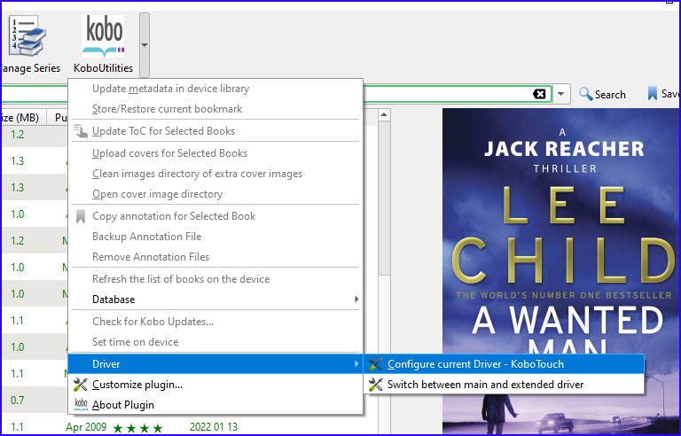

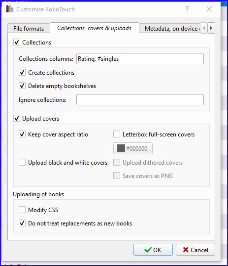

Hi
You need to install the Kobo Utilities by @davidfor... https://www.mobileread.com/forums/sh...d.php?t=215339
Once you set up the plugin, go to Driver>Configure Current Driver and enable Collections.
You can then add which columns the collections should be based on. In my example I am using Ratings and my own column "Singles" for Collections.
Hope that helps.

Originally Posted by Karellen View Post
Hi
No you don't. My Kobo Utilities plugin has absolutely now way of creating collections on the device. And, calibre has everything built in for connecting to Kobo devices. The plugin adds function, but, not this.
That is correct, but, it is the built-in driver, not the plugin.
@T6J2E5: Start with https://wiki.mobileread.com/wiki/Kob...nd_Collections. That is a guide for using collections. And there is a long thread, https://www.mobileread.com/forums/sh...d.php?t=193184, where most of the issues have been discussed.
Hmmm, sounds like my understanding is still a bit suspect. So why do you have that page in my screenshot in your plugin settings, and why can I add column names then those names magically appear as Collections on my Kobo.
I read that wiki page early on, but it was confusing and to me it seemed as if it was mixing series and collections. But I was coming at it completely new, so maybe I missed the nuances of some of the statements.
That is not a screenshot from the Kobo Utilities plugin. It is a screenshot from the KoboTouch driver which is built into calibre. It might be a screenshot from the KoboTouchExtended driver, but, that particular tab is the same in both drivers. As it's name suggests, the KoboTouchExtended driver extends the KoboTouch driver and relies on that for most of the function. If you uninstall or just disable the Kobo Utilities plugin, the driver configuration will still be there. And the driver will work as it is supposed to.
The Kobo Utilities plugin does have a way to open the driver configuration. But, that is just a menu item because I was sick of digging through the calibre preference to find the drivers.
This gets back to something I find annoying. There are people here and in other places that say you must install the Kobo Utilities plugin and the KoboTouchExtended driver for calibre to work with Kobo devices. This is not true. Both supply extra function, but, calibre will connect and update the books on the device quite happily without them. When asked by a new Kobo user what to do, I always say to put books on the device and read. And play with it. Then they can work out what they do and don't like. And they can decide what else is needed. And if they decide that "what else is needed" is nothing, or a Kindle, I'm fine with that.
The original set of instructions for collections highlighted the use of series for collections as that was a popular request. For recent firmware, it isn't as important. Then, sometime last year, someone added a tutorial that was specifically for using the series column but not using it for actual series. The comment in red above it is mine as the instructions have caused problems, but, I haven't had time to rewrite them. And I'm not quite sure what they should be. And, I keep hoping someone else will do it
Oh, right. Ok I know where my confusion has come from. The way I access that particular settings page is through the icon for your plugin. See image.
I assumed it was part of your plugin, because that is where I was accessing it. Instead, as you describe, it is a convenient shortcut. Hmmm, if I did not have your plugin and that icon on the toolbar, I would have been hard pressed finding the setting.
I don't have the extended driver installed.
Yep, I am one of those people
You have previously corrected me with Series, by explaining that disconnecting and reconnecting updated the series metadata because I mistakenly thought it was your plugin that was updating the metadata.
Thank your again @davidfor for explaining how Collections works.

Wiki's are a great thing, but difficult to maintain. I admin another wiki elsewhere and it does my head in at times, trying to keep up.

Short answer:
  1. Calibre/Preferences/Change Calibre behavior/Plugins/Device Interface/Kobo Touch (or Kobo Touch Extended).
  2. Click the Collections, covers & uploads tab.
  3. Click the Collections box
  4. Collections column - Tags
  5. Click the Create collections box (I also check Delete empty bookshelves)
Since using this, I have become very conservative in my tag usage as every single tag creates a new collection. I would get frustrated when there was a collection for Western and one for Westerns, for instance.
