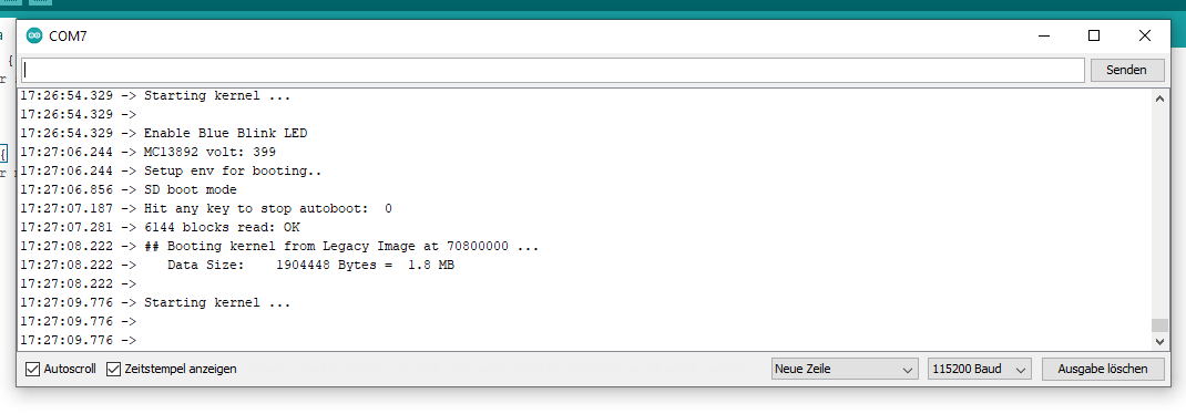

soldered rx and tx to an arduino and tried the 905b image
seems that it dosnt work with the *b image. i tried the *c image as well with same results.

So you can't "Hit any key to stop autoboot"?
Probably not, all those old Kobos have bootdelay set to 0. You might still try. If you get to the U-Boot command line, then debricking is possible.
