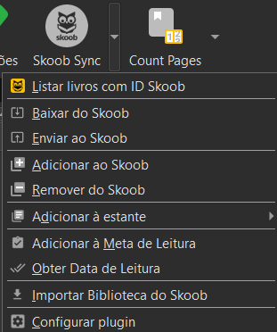

I've just noticed that my plugin icons are being drawed with a lower quality then before. Also noticed a shadow on some checkboxes (why not all? ).
5.34 / 5.99(Beta)
Name:	5.34 - Menu.png
ID:	191233Click image for larger version
Name:	5.99 - Menu.jpg
Name:	5.34 - Config Window.png
ID:	191235Click image for larger version
Name:	5.99 - Config Window.jpg
There are also some separators missing on the beta, although using the same code (m.addSeparator()) for all of them.

This will fix the drop/hover event errors: https://github.com/kovidgoyal/calibr...c60100810b09e5
@thiago.eec: No clue about your icons, most likely a DPI thing. Try using larger icons.
Strange, since it renders ok on calibre 5.34 and older versions.
Also, what about the missing separators?
Found the solution on their porting guide.
Qt 6 changes the default scale factor rounding policy from Qt::HighDpiScaleFactorRoundingPolicy::Round to Qt::HighDpiScaleFactorRoundingPolicy::PassThrough in order to track operating system DPI settings accurately. Applications that use Qt Widgets may encounter graphical glitches at non-integer scale factors, for example on Windows with a display configured for 175%. In that case, set the rounding policy to Round to restore Qt 5 behavior.
Since I use a non-integer scale factor on my windows machine, this was causing the problem. So, to correct it, i restored Qt 5 behavior setting the policy to Round:
QApplication.setHighDpiScaleFactorRoundingPolicy(QtCore.Qt.HighDpiScaleFactorRoundingPolicy.Round)
thiago.eec is offline   Reply With Quote
That doesnt explain why it affects only plugin icons though. Is it because they are too small?
I'm guessing* this is it.
Anyway, my fix backfired, since it sets the Policy for QApplication, messing with whole calibre. I guess I'll have to change all my icons for larger versions.
P.S.: The shadow on checkboxes borders happens on main calibre either.
* Confirmed. Using larger images fixes the problem.
