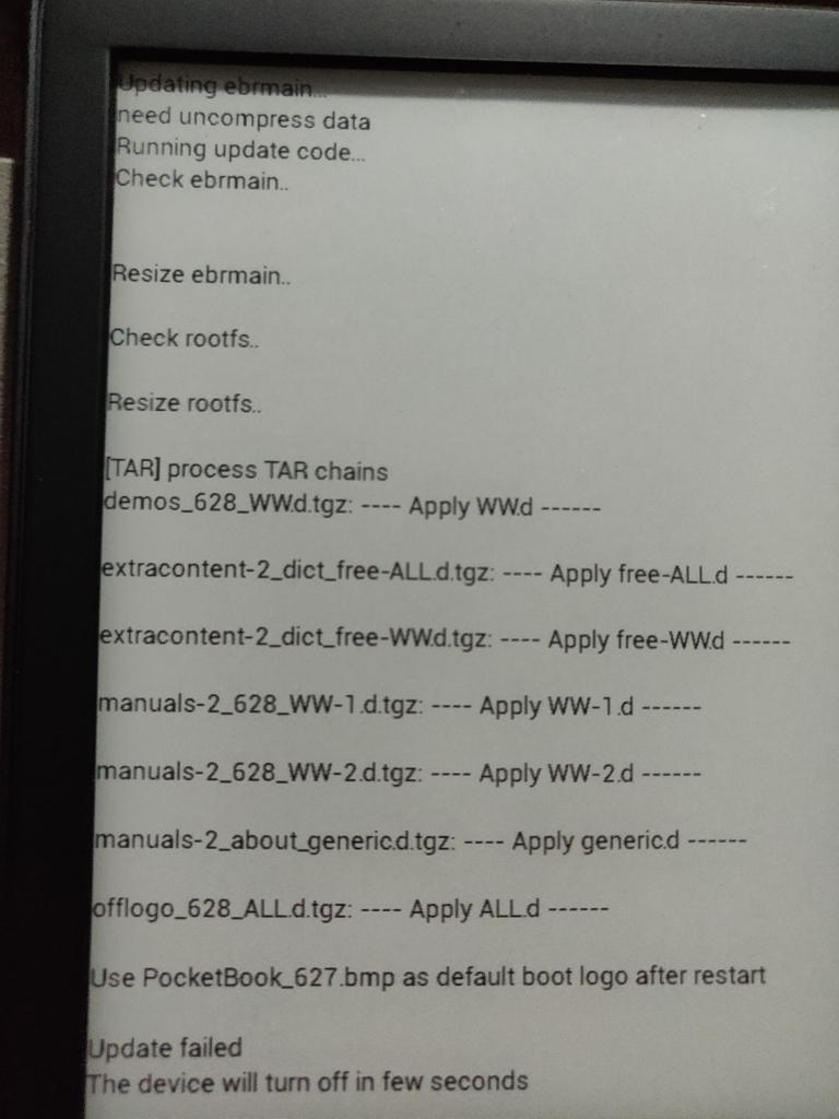

@rcentros As I said befored I tried to manually copy the file to the device and use your well known procedure to update software but with no luck.
Every time I do this (no matter if it is swupdate.bin file from 6.5.1089 or 6.5.1433) it ends with this:

I had a comparable problem once. Turned out to be a failed update/memory error which killed my bootsector. Pocketbook had to replace the mainboard for me.
Regarding your problem: I would try to get my hands on the oldest update you can get and try a manual downgrade. If this doen't work contact pocketbook service for a solution.

@nhedgehog Ok. I will try it. The oldest one on the PocketBook is 6.1.408. Lets find out if I will be lucky...

Things are getting weirder: after I downgrade system to 6.1.408 touchcreen started working fine. As soon as I try to update system to any version (like 6.5.1089 or newest 6.5.1433) same error occured and touchscreen stop working again.
I will try to contact service.
