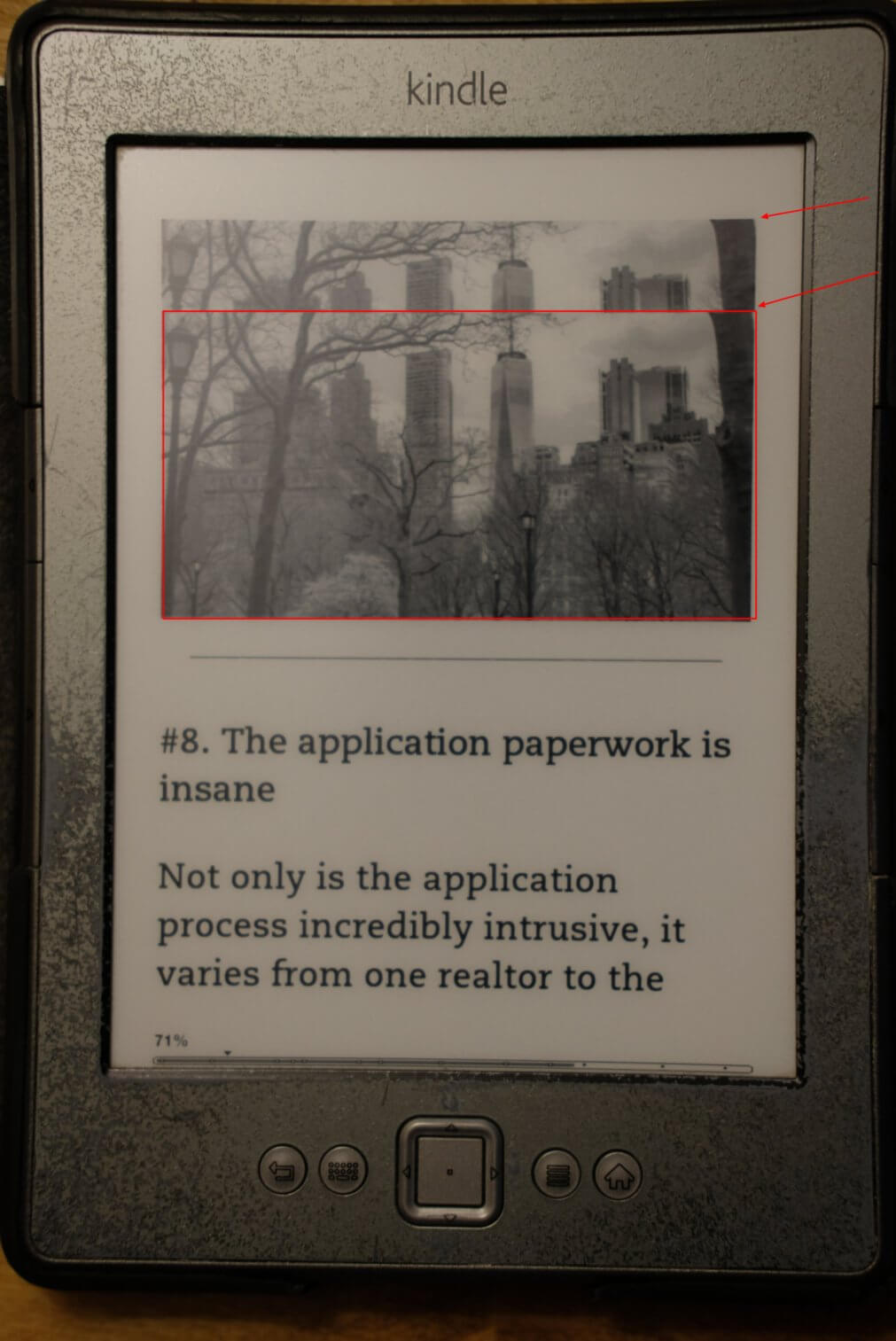

I'm getting some overlapping images in mobi files. Attached is a photo of what I'm seeing on a Kindle. This is happening if I use the `ebook-convert` command via the terminal or using the Calibre GUI. Any ideas how to fix this?

Do you mean the whole HTML file? The image code in this case is this:
<figure><img src="moving-to-new-york-city-during-covid/one.jpg"></figure>
There is no CSS included in the the zip.

I guess I was wrong. I do remember seeing something like this before but it was a long time ago. In that case the doubling was actually present in the images for some unknown reason. Some sort of problem during image conversion.

In my case, it is only on the Kindle. When I use Calibre to view the mobi file it is skewed to fit the width, but there is no doubling/overlapping.

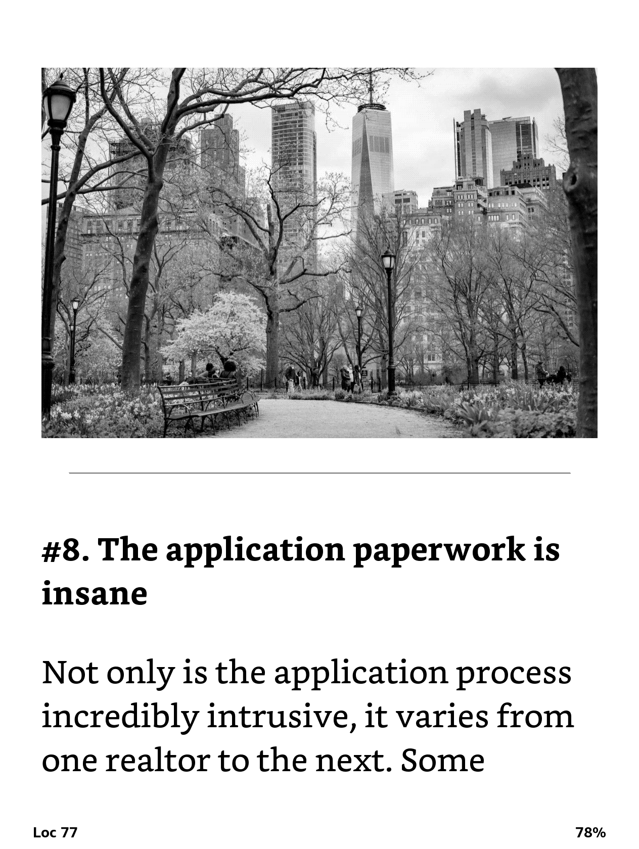

Originally Posted by bradonomics View Post
Attached is the mobi
It worked fine on my Kindle. See attached.
P.S. What is "old" mobi?
Calibre supports three options for conversion to MOBI: old, new, and both. Your file was created using the old option as was mine done previously.
