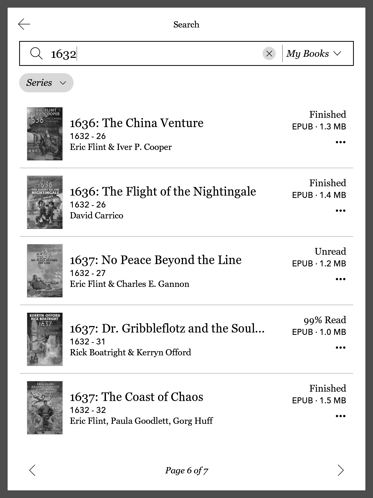

Why are you adding the series to the ebook title? Your Kobo is quite capable of displaying the title, subtitle and series information. If you tap on the ... below the book status/type, you can view the full title in the book details.

No, it's not calibres fault. Or at least not exactly. The book details are displayed as:
Title
Subtitle
Series name - series number
Author
The title and author are mandatory. If neither the subtitle or series info is present, the title will wrapped over two lines before being truncated. If either the subtitle or series info are present, then the title will be truncated at about 26 characters (assuming I counted properly).
The only reason calibre is at fault is because that is what you are using to set the series info on the device. But, you can turn that off if you don't want it. But, reading your other posts, you appear to be adding the series info to the title, so you are probably getting longer titles that don't actually show as meaningful and duplicating information on the screen. And you can see the full title by going to the book details screen.

Firstly, the subtitle is exactly what it says on the tin. A subtitle given to the book by whoever created the metadata. Strictly, it only comes from books downloaded to the device from Kobo. But, the KoboTouch driver can populate it if you configure it to. And if you have not configure the subtitle option, the subtitle will not updated by calibre.
As to the length, I don't think there is a limit. If it is to long, then it will be truncated in the list and more will be displayed on the details page for the book.
But, I think you have completely missed the point. If either the subtitle or series is there, then a long title will be truncated. If neither are there, the title will wrap over two lines before getting truncated. What you need to decide is what information you want to display. Do you want to see the series info, or are the title of your books so long that you need to see the full title and are willing to not have the series information. And, you also need to look at the actual title you are putting on the device. From your examples, these are not just the title, but other information. Is that extra information really necessary? Maybe it would be a good candidate to go into the subtitle or series.
Of course, another alternative is to by a bigger ereader. The 8" devices will fit a few more characters before they are truncated or wrapped. There might also be a patch to change the size of the font used and let more characters be displayed. Or you could possibly use the large print mode, but, manually set the scaling to less than one in the config file. I'm not sure if that will give more characters or not.
