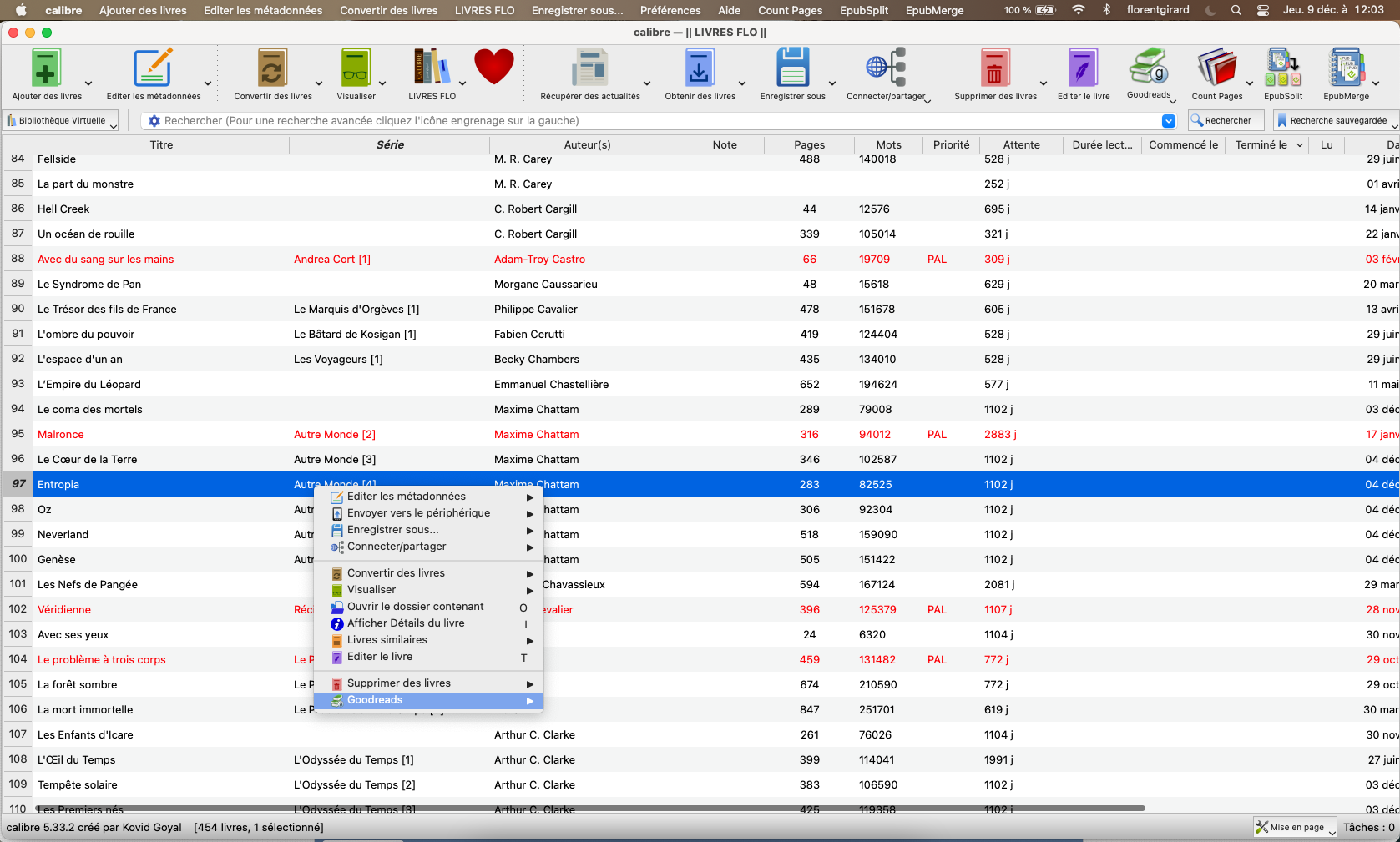

I have a question about the book context menu and Goodreads Sync: is it normal that it is empty (see picture)? If not, what can I do to have it working properly?

Originally Posted by wff View Post
Hi everyone,
It isn't empty here on my Win10 machine. It might work differently on a MAC. Are the other submenus opening? Do you have to click on them, or just move the cursor over the parent menu item?
Hi everyone,
Thanks!
Not empty here either, on my Mac.
Have you set up the plugin - i.e. linked it to your Goodreads account and set up some rules for adding/syncing books?

Thanks for your answers.
Yes, the other submenus are opening well, I don't have to click, just moving the cursor is OK (but GR submenu doesn't work even if I click on it).
Yes, the plugin is linked to my GR account, adding to and sync from work properly. I have set up some rules, but I need to click on the GR plugin icon in the icon bar to make it appear.

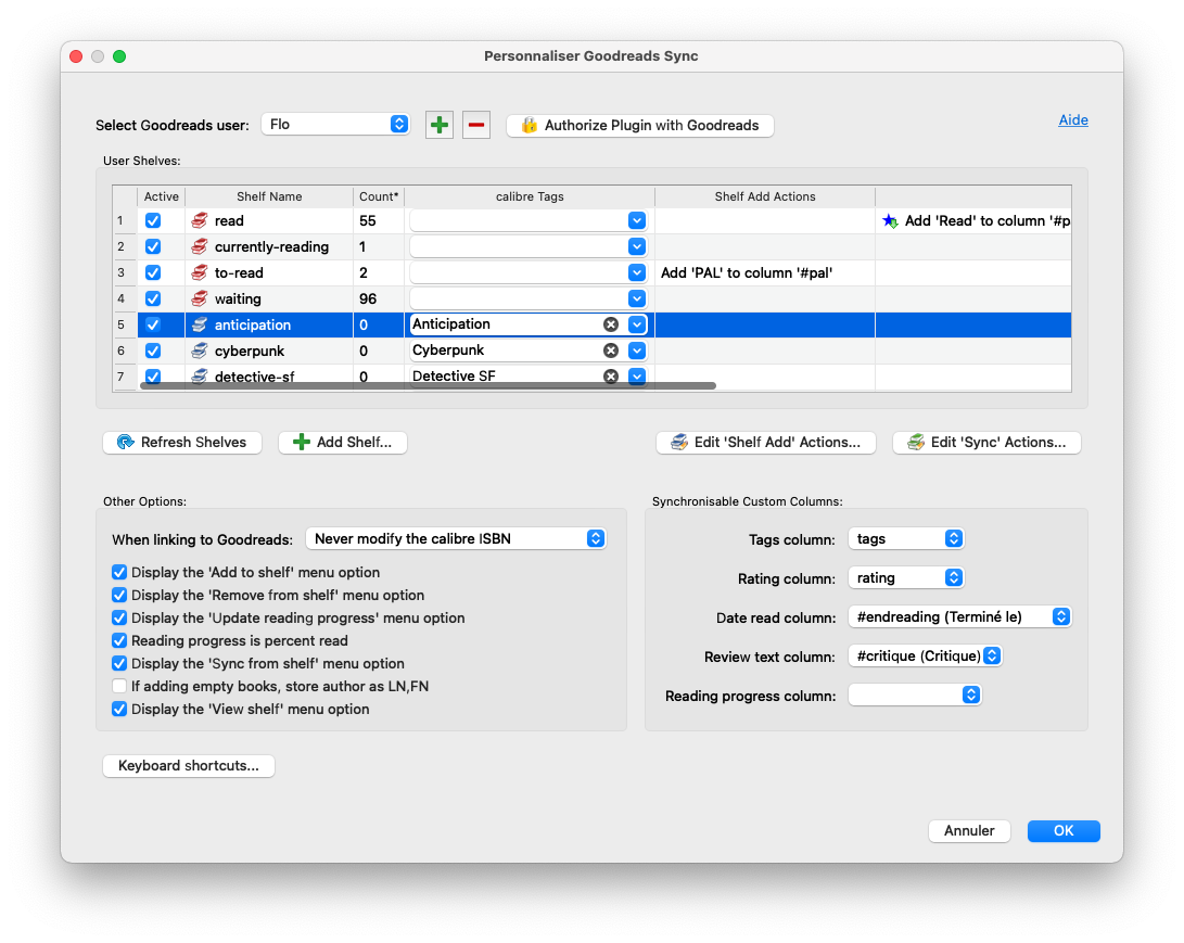

Here is a screenshot of the plugin settings.

Following your suggestions, I unlinked my GR account and uninstalled the GR sync plugin, then reinstalled and linked again, and it is now working as expected.
Sorry for disturbing and thanks again!
