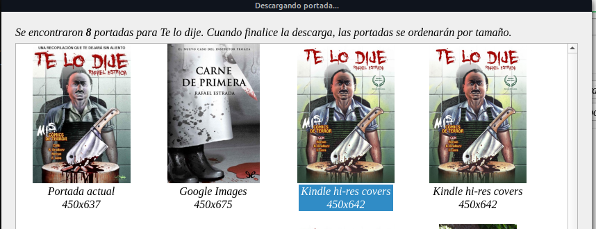

It works like this, in order (stops at first existing identifier):
- if there's an ASIN, then that one is used
- if there's a Goodreads identifier, the existing Kindle editions for that book are used
- if there's a ISBN, then Goodreads is searched by ISBN instead
- otherwise Goodreads is searched by author+title
lbschenkel is offline   Reply With Quote

For books with multiple Kindle editions on Goodreads, how does it choose between them? When I don't provide an ASIN, the covers that come back are often for other language editions. Is it feasible for the plugin to see if there's a Kindle edition whose language matches the one specified in calibre?
Thanks!
jbusnengo is offline   Reply With Quote
When the plug-in resolves to a Goodreads entry (via identifier or ISBN), then *all* Kindle editions are used.
When the plug-in has to search for the book, then the first Goodreads match is used and it proceeds as above.
Regarding only using same language for Kindle editions, that's a nice suggestion. I'll need to look into it. However, I'm on a big holiday break overseas so I don't expect to be able to do much in the next 3 months or so.
