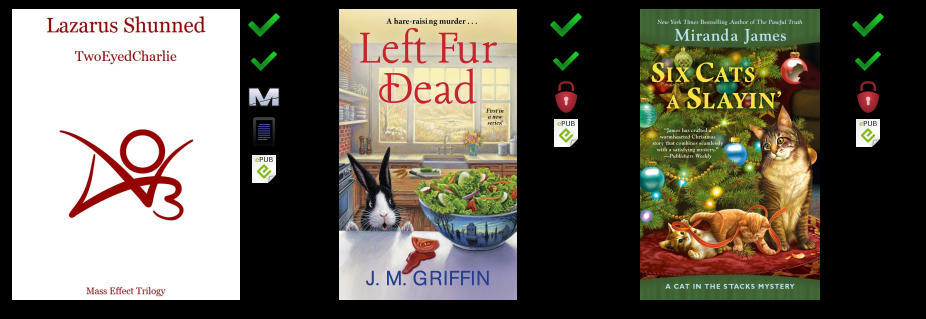

Can I replace the on-device checkmark icon?
It's a bit confusing when looking at read books in cover grid mode:
Name:	2021-12-13 06_21_24-Window.png
However, I'm afraid that if put a replacement for ok.png in the appdata folder, it'll replace other green checkmarks. Is there anything to be done?
Attachment 190803
Using ok.png is hard coded for ondevice and all other booleans. If you really want to change it then you need to change calibre's code, specifically line 804 of gui2/library/model.py. This doesn't apply when using the cover grid.
EDIT: You can of course change the other icons using the emblem editor.
EDIT 2: The code to change to see a different ondevice icon in the cover view is line 503 of gui2/library/alternate_views.py

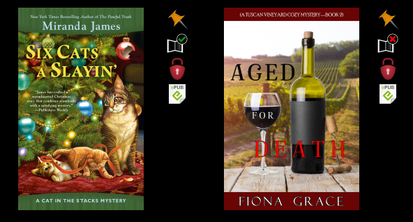

I found this and this (bit annoying to require registration to dl free icons, but I have throwaway emails) and then did a bit of editing:
Name:	2021-12-13 23_45_28-Window.png
Didn't downscale too well though. Those jaggies are especially bad in column icon mode:
Name:  2021-12-14 00_05_30-Window.png
