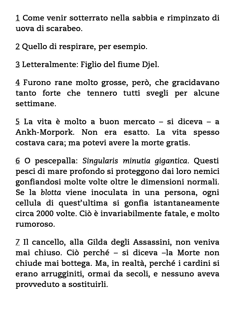

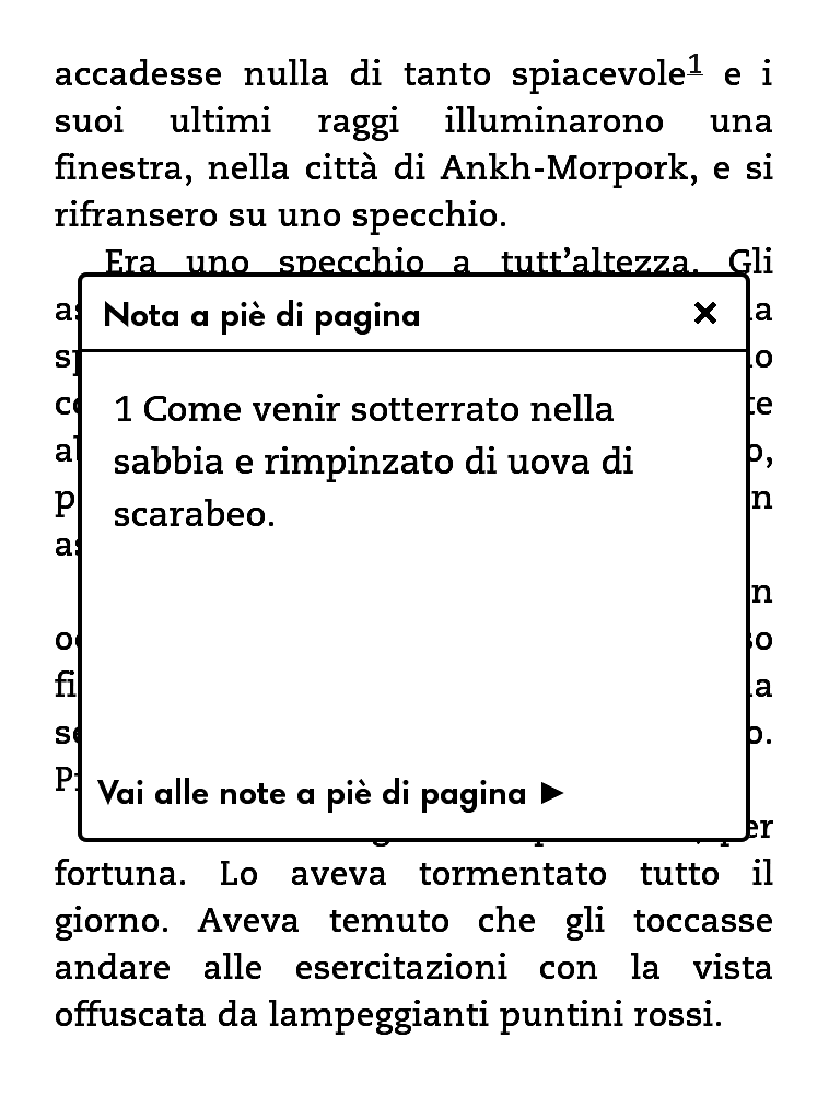

Hello, I've got a problem with an AZW3 file that I converted from EPUB with calibre to send to my Kindle PW1. It wasn't a well made e-book, so before conversion I opened it with calibre's editor to improve it.
Among the things I modified were the endnotes and although they look good on my pc, they have a big margin on my Paperwhite, but only in the popup view. At the end of the book, with all the notes together, they have the right spacing.
This is a sample of the code I used (already converted to AZW3):

The results are attached. Is the Kindle's renderer inflating the spacing? Or did I make a mistake? Because The 2nd screenshot is exactly as I want it, but in the 1st there is a huge bottom margin I'd like to remove.
Thanks for the help

I don’t think it is a bottom margin. It is just that the box displaying the footnote is a fixed size.
That's not it, I've got other books that show the popup correctly and the box size changes, with both short and long notes (and without any margin). I will check their CSS and change my book accordingly if I don't find a solution, but as far as I can tell my method should work too

You have a fairly old Kindle that cannot run the latest firmware. I suspect that the results may vary based on Kindle firmware version and file format.
I am curious to learn what you find from examining other books.

Ok, I did some testing in the file and half the space disappears if I remove the div container for the single note. The other half disappears if I remove the div from the following note (I had ~20 notes in the file that I didn't include in the sample code here). There may remain a very little margin, but I'm not sure.
It would seem that my Kindle's renderer doesn't like a note incapsulated in a div. Removing them would be a bit annoying since I have some notes which are made of 2 paragraphs.
Now it's night time where I am, but I'll try other combinations tomorrow

Ok, after a lot of testing I finally found the problem, and I can't believe what it was...
This code causes problems:
<div class="endnote">
      <p class="note"><a href="part0002.html#note-1" id="endnote-1">1</a> Come venir sotterrato nella sabbia e rimpinzato di uova di scarabeo.</p>
    </div>
This doesn't:
<div class="endnote"><p class="note"><a href="part0002.html#note-1" id="endnote-1">1</a> Come venir sotterrato nella sabbia e rimpinzato di uova di scarabeo.</p></div>
HTML wise they are exactly the same, except for the spaces and newlines that I candidly put in with the calibre Beautify tool. Who wouldn't want a clean-to-read code right?
Wrong.
Kindle's renderer decided that the spaces and newlines between </p> and </div> are important, and they should be shown as margins. Even only adding spaces causes smaller margins to appear. I don't even know how it occurred to me to try and remove those spaces...

Removing the divs solves the problem too, but I liked having one note per div, it's more rigorous and now that I have a solution I might keep them like this.
