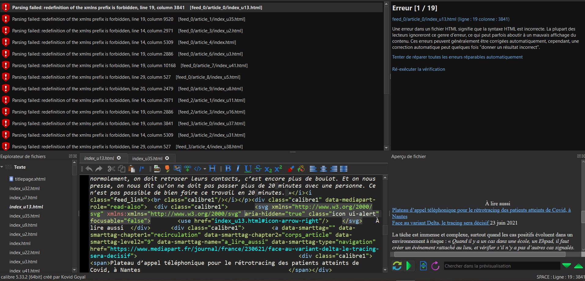

Okay so I deleted lines 45 to 49
keep_only_tags = [
        dict(name='h1'),
        dict(name='div', **classes('author')),
        classes('introduction content-article')
I used Calibre's ereader and it worked (although it downloaded pretty much the whole web page instead of just the article, but I imagine that's the point).
The issue is that when I transfer the ePub to my Libra I can't access the articles. Going to the next page, even choosing a particular page, send me to the next article's first page (the one with links to the table of content).
The ePub is 1700 pages long (!!) when it used to be ~250.
The articles are there, it just won't let me read it
Thanks for your help !
MoloBolo is offline   Reply With Quote

Thanks a lot, sadly it's not working for me. It's perfect with Calibre's ereader but the articles are randomly cut on my Libra.
It always cut just before the links to other articles ("à lire aussi"). Kepub conversion didn't help so I ran a book check and got 19 "Parsing failed: redefinition of the xmlns prefix is forbidden" errors (screen attached).

I'm assuming those links are the issue, at least with Kobo Libra (that's where it cuts and where the errors are), but I have no idea how to fix this.

Just add svg to remove_tags in the recipe.
Old 12-05-2021, 07:35 AM   #9
MoloBolo
MoloBolo began at the beginning.
Posts: 8
Join Date: Nov 2021
Device: Kobo Libra H20
I added this :
remove_tags = [dict(name='svg')]
and ran a book check and now I have 150+ new errors
I tried to add stuff like "class" which didn't help, and eventually decided to test it on my Libra anyway...
It's working
I didn't notice any cuts and the table of content is functional.
The full recipe :

I can post screenshots of the errors if anyone is interested, errors are :
  • Missing standard property 'border-bottom-right-radius' to go along with '-webkit-border-bottom-right-radius'. [stylesheet.css]
  • Link points to a location not present in the target file [feed_0/article_0/index_u27.html]
  • The linked resource 'w.colibris-lemouvement.org' does not exist [feed_0/article_2/index_u1.html]
Thanks a lot for the help !

InputFormatPlugin: Recipe Input running
Downloading recipe urn: custom:1000
Using user agent: Mozilla/5.0 (Windows NT 10.0; Win64; x64) AppleWebKit/537.36 (KHTML, like Gecko) Chrome/80.0.3987.87 Safari/537.36
File "runpy.py", line 194, in _run_module_as_main
File "runpy.py", line 87, in _run_code
File "site.py", line 82, in <module>
File "site.py", line 77, in main
File "site.py", line 49, in run_entry_point
File "calibre\utils\ipc\worker.py", line 215, in main
File "calibre\gui2\convert\gui_conversion.py", line 31, in gui_convert_recipe
File "calibre\gui2\convert\gui_conversion.py", line 25, in gui_convert
File "calibre\ebooks\conversion\plumber.py", line 1108, in run
File "calibre\customize\conversion.py", line 242, in __call__
File "calibre\ebooks\conversion\plugins\recipe_input.py ", line 137, in convert
File "calibre\web\feeds\news.py", line 1056, in download
File "calibre\web\feeds\news.py", line 1233, in build_index
File "<string>", line 74, in parse_feeds
File "<string>", line 215, in my_parse_index
File "<string>", line 131, in get_articles
AttributeError: 'NoneType' object has no attribute 'find'
Not sure what's the issue ? It was working fine yesterday and I didn't change anything since.
Thanks !

It means the website has changed and the recipe needs to be updated.
