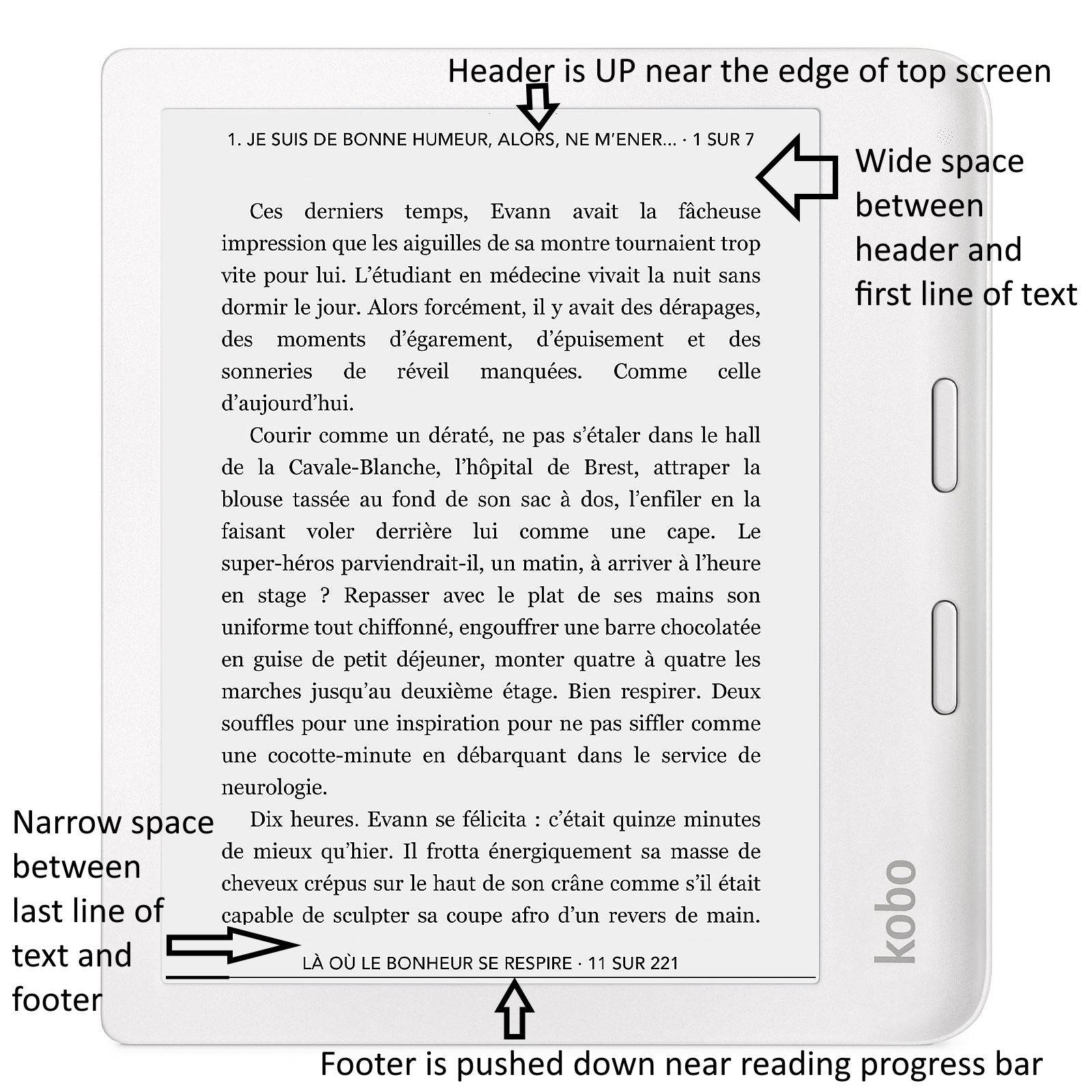

BUT I think i made a mistake in my question. What I meant was the space between the edges of the screen (top and bottom) and the caption (The header and the footer, i.e. Chapter and Title of book) and the text.
To explain, i attched an image of what i want to do.

Check out the 'Reduce new header/footer height' patch and try changing the line spacing in the reading settings.
Thanks, but adjusting the line spacing adjusts the spaces between each text lines.
What I want is a bigger space between the header and first line only; and a smaller space (compared to the space between header and first line of text) between the footer and last line of text?
Deobulakenyo is offline   Reply With Quote

Join Date: Jun 2016
Device: Kobo
And also affects the free space at the top and bottom. You tried to change or immediately unsubscribed, without checking...
Can those two spaces be set to definite gap independent of the line spacing, so the text can have smaller spaces but the gaps on those (header and first line; and footer and last line) will remain constant?

Device: Kobo
Here is a visual aid, how and what is changing. To reduce the footer and header, the Reduce new header/footer height patch is used.
And using the line spacing, you can choose the optimal distance.
