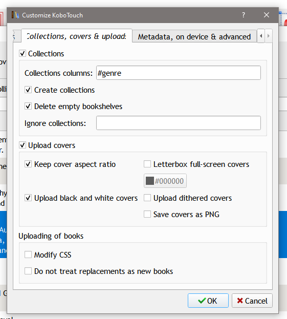

What theducks said. Here's how my KoboTouch is configured. Note the grayed out "Set series information". It becomes selectable if I uncheck "Update metadata on Book Details pages".
ID:	190298   Click image for larger version
hobnail is offline
