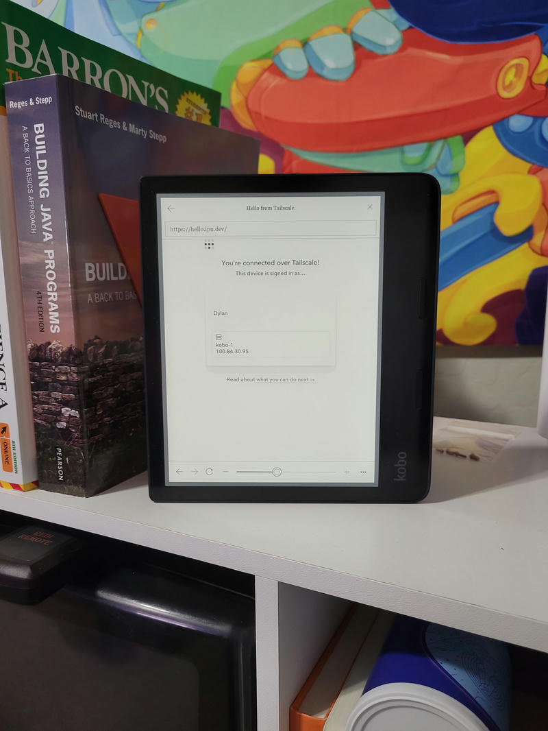

After authenticating, the final step was to open a Tailscale-only URL in the Kobo's experimental web browser to confirm that I was, indeed, connected to my Tailscale network!
