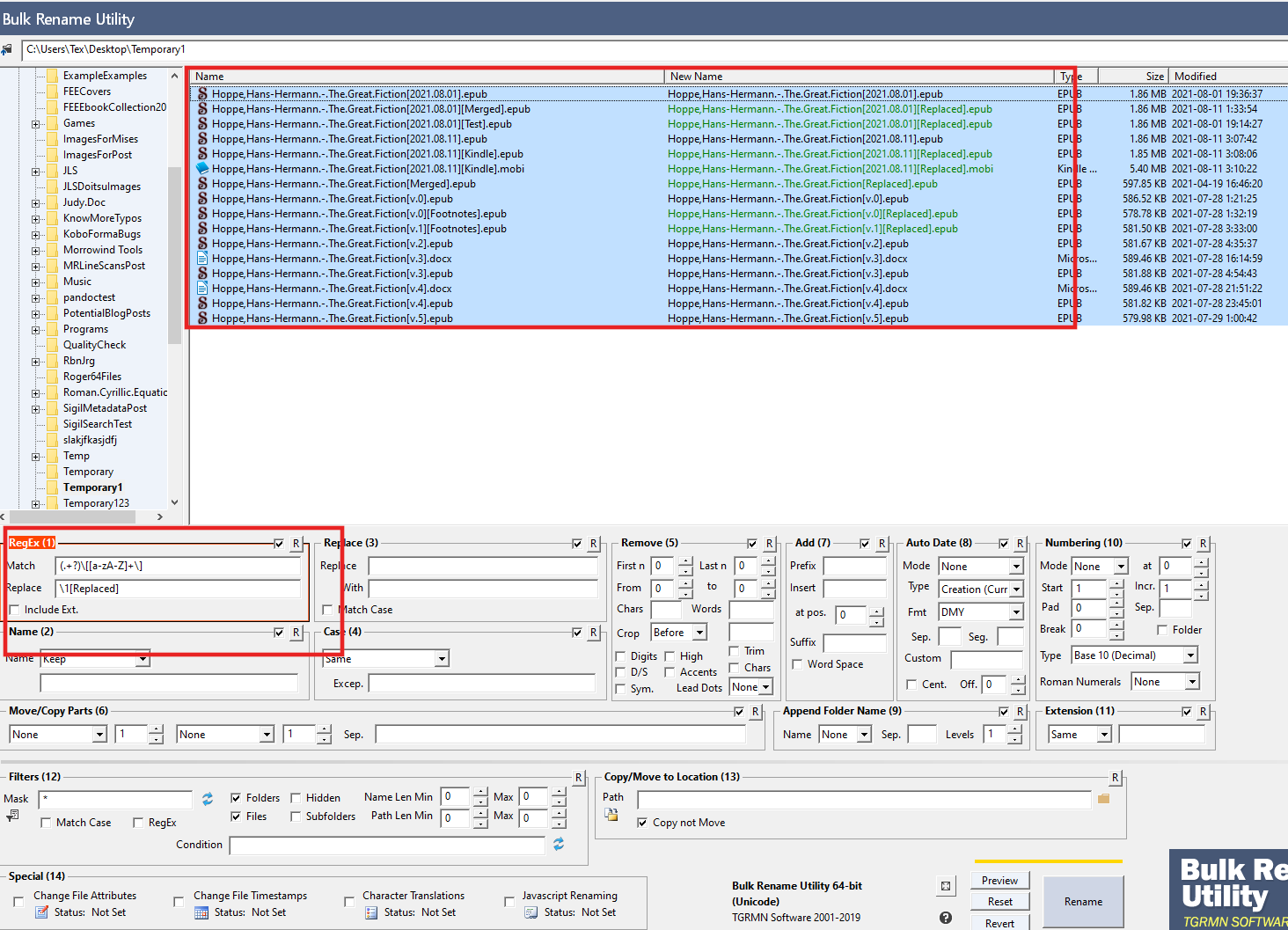

2. A tool like Bulk Rename Utility allows you to mass search/replace filenames:
Attachment 189406
You fill out your parameters below.
Then you select which files you want to apply it to (Ctrl+Click/Shift+Click).
It puts green highlight on the files that'll actually change, and shows you the before/after in 2 columns.
I also believe this would be helpful in the normal large Find/Replaces (with a handful of edge cases).
