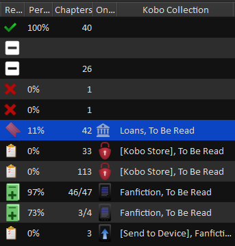

- Reading status. I have a boolean yes/no column for #read, but I heavily use icons. If I'm currently reading the book, a bookmark will appear there. If it's on my reading list, it'll show a little clipboard. I've also got a specific icons for fanfics that have a new unread chapter.
- Device status. If a book is on my Kobo, it shows an icon. If it's on my send-to-device reading list, it shows a different icon. If it's a Kobo Store book, it shows a DRM lock. If it's a book borrowed from Overdrive, it shows a library icon.
Here's my reading status and device status columns in action:
Name:	2021-10-20 00_54_48-Window.png
(Curious about how I did the chapter count on the fanfics? Here you go.)
