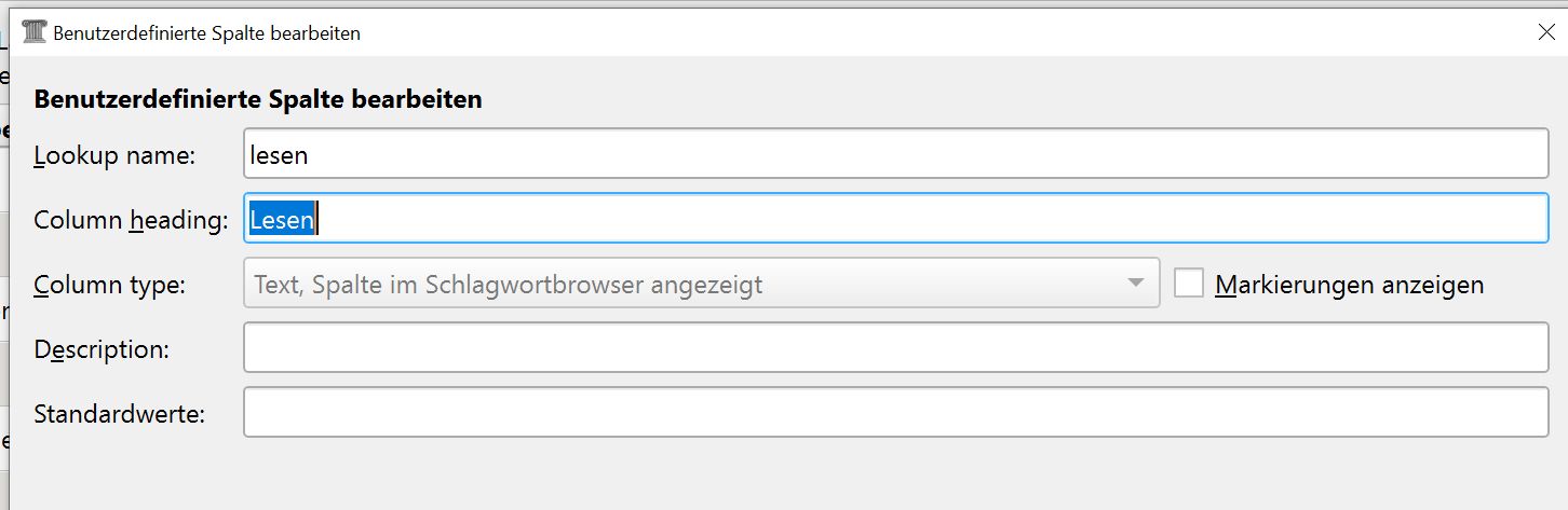

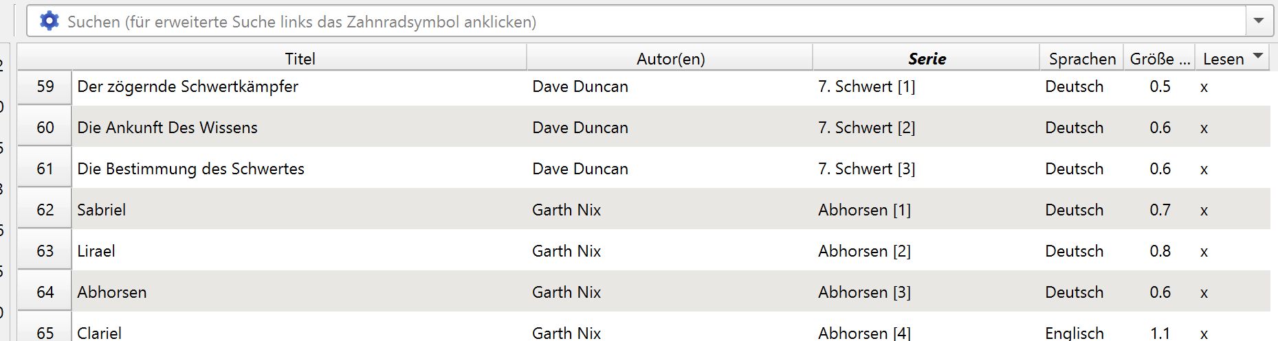

Column definition?
Hi,
I have no idea how to check column definition.
here is a screenshot of my list.
At the moment the x are all ther, so I can give you no before pic
Please post screen shots of:
1) the column definition into which you are putting the 'x',
2) the book list where the 'x's are missing, and
3) the book list after clicking the name of the column, where the 'x's reappear.
I suspect it's something to do with sorting.
Thank you.
Poldi is offline   Reply With Quote
Old 10-14-2021, 05:34 PM   #8
Posts: 22,404
Karma: 31000056

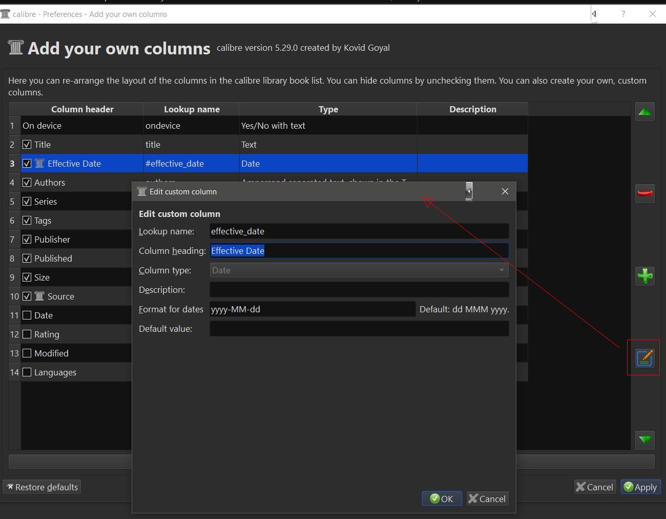

Originally Posted by Poldi View Post
Hi,
Thus:
Name:	Screenshot 2021-10-15 073142.jpg
The 'Lesen' column header has a down arrow which means its the sorted 'column', the un-x'd books will grouped at top of list, if you sort on another column the un-x'd books will scattered thoughout the list.

Column definition
Got it.
Here is a pic of the definition. Seems to work fine now.
Thank you.
