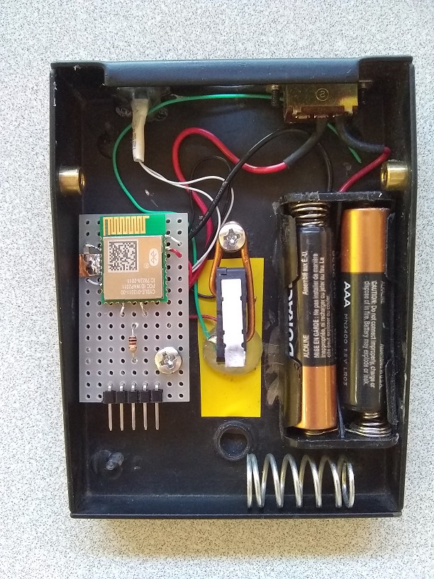

Here's my latest project, although I'm still fighting with software fine-tuning. This pedal is mostly for guitar playing in the park, something small I can throw in my pack.
The original is an MAudio wired foot pedal. It sells for about $10. I kind of like the metal and the size but you have to make a few mods to use this for Bluetooth.
  • I replaced the simple wire contact switch with a microswitch
  • Removed the output cable
  • Ground down a post and glued in a dual AAA battery holder
  • Installed the Bluetooth circuit board
  • Ground the nub of the power (formerly polarity) switch down to half its height so that the power wouldn't accidentally get turned on.
  • Installed an LED in the back to indicate pairing
  • Cut an opening in the top of the pedal for the BluRays to escape
  • Replaced the original top tread with a thicker rubber one (because of the new hole)
Except for that, it's the same as stock.

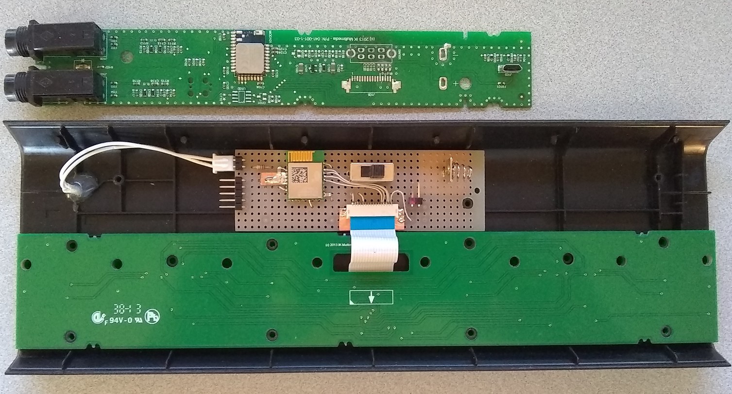

I want to make my own clicker. I ordered some cases, they are the Serpac CA-4-4B (4 button). I was quite pleased when they showed up. They have 4 buttons in a weird Klingon-ish pattern but widely spaced. I think this will be a big improvement on those 5-way switches that are so tiny and it's easy to hit up and right at the same time. This is just the case, I'm working on the PCB.
The software is all working out well. I also retrofited an iRig BlueBoard and I'm quite pleased with it. I don't need to use a translator app to make it work with things and the button backlight is easier to turn on with a press on the outer two buttons (instead of having to go to some app and hit a slider).
Edit: So I did the board design, hit Enter and now the design is at the fab. I hope it gets here soon.
