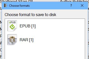

The results from Find Duplicates PI can be acted upon directly (Just 1 at a time) Select target FIRST,the select additional records to Merge into the first, "M" (is the hotkey) This deletes the sources. You can also right click AFTER making the selections for options to Merge
@Kraft you saw my picture. That is the way to do it.
I just checked and it shows any format, even though Preferences: Behavior is set to EPUB
I don't know WHY you cant see the choice if the DB passes the checks.
Here is what I see for Send to Disk (single format)
Your attached picture is not what I see.
Perhaps some of my settings need changing to see what you are seeing?

@theducks - firstly I do not use the Add Books Automerge feature, secondly your image comes from Save to Disk, there is no such thing as Send to Disk.
But like the OP I'm confused, how does Save to Disk come into play with Find Duplicates, Add Books, Copy to library etc. I thought Automerge on Add or Copy was determined by the settings in Preferences->Add Books->Adding Actions.

He asked IF I MERGE, can I specify what format to send to device.
I answered 'use the option'
He claims that he does not have the menu item to choose formats on Send to Device.
I then asked if the Save to Disk had it (the image)
Something is really odd
Yeah, seems so.
I suggest post 892 be copied to a new thread in Lib Mgt, and all posts up to this one be moved into that thread. Having long 'OT' discussions, particularly in plugin threads, makes it really hard for anyone to follow.
