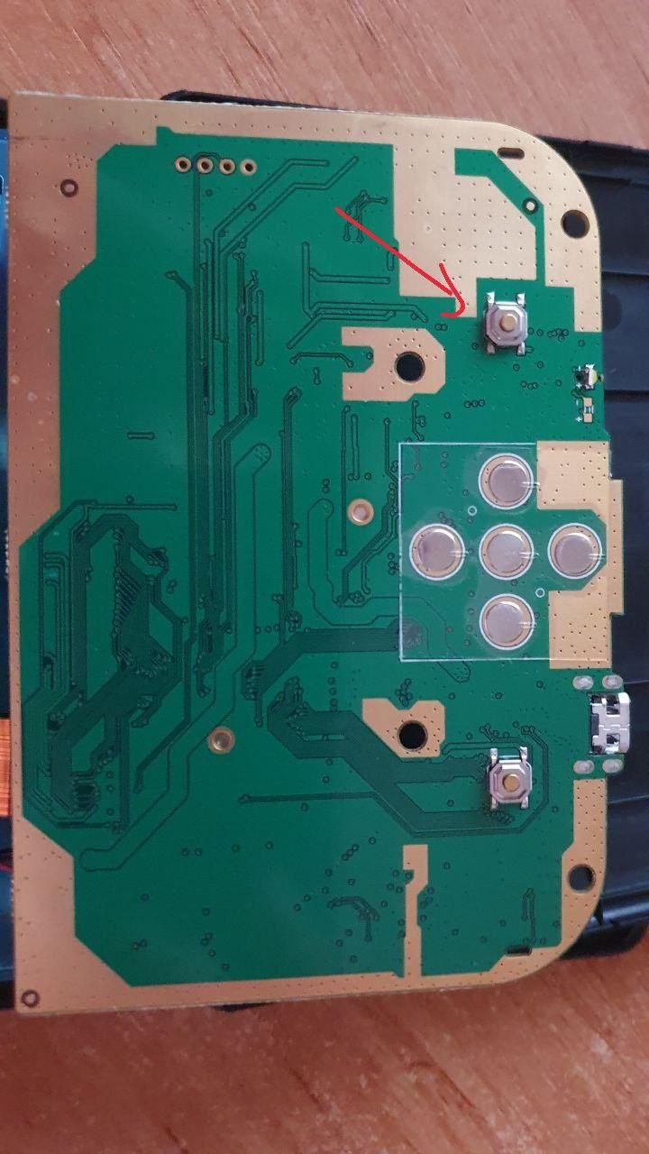

Edit: attached photo of board

No we are not, I made a red circle around it. Are you sure about the other button?
The button you are pointing is different to repair. Did you try to press it a couple of times. How does it respond?
nhedgehog is offline   Reply With Quote
The button I pointed: it feels normal when I press it down, but the LED tester shows that the circuit is always closed, as if the button is always pushed down.
The opposite button and the power button: also feel normal to touch. LED tester shows that the circuit closes only when I push these buttons, so they are not stuck.
The round buttons on the directional pad: I don't know how to test these because the four pins I was using to test the other buttons are not exposed. These buttons also feel normal to the touch now that I have freed them from the front cover (but yes previously they felt weird through the plastic pad).

You didn't free them before. Try to click them several times especially the right D-pad button. After that try to boot up the device.
PS: One contact is the outer rim of the button, the other is probably on the other side of the board.

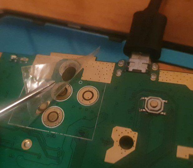

OK, I see now. On my D-pad there are metal disks covered with metal caps (no sign of rubber), and all 5 metal caps are held on the D-pad with a transparent square of sticky tape (photo). It looks like one contact of the button is the inside region, the second is the outer region, and the circuit is closed by the metal cap pressing down and bridging the inner and outer regions. I removed all metal caps, to prevent all the D-pad buttons from closing their respective circuits, but the device still won't boot.
So at this point the only abnormal button is the one I pointed, which has a closed circuit whether I press the button or not. So that must be the button that's stuck in the "ON" state. How do I take this button apart?
ID:	189442   Click image for larger version

That will be difficult. Unsolder it, see if the device boots up. If yes you can try to pry it somehow mechanically open and repair it or look for a replacement in the internet.
