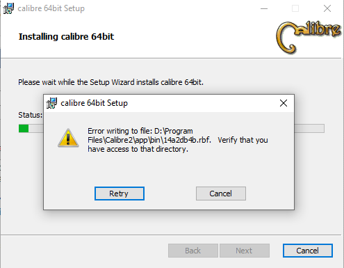

Came here to see if others were having issue as well. I'm having a very similar problem, however my file it's complaining about is 14a2db4b.rbf.
See attached screenshot. I even manually changed the security permissions just for that file, still didn't help. I tried installing with and without Windows Defender activated, still same issue. Have never had a problem updating via msi until now (tried each msi i downloaded from all the links on the website, in case one of them was borked).
Any ideas? So weird.

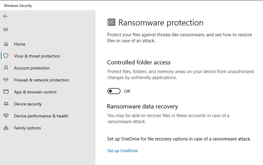

I suspect that file is a R(oll)B(ack)F(ile), thus the serial numbering.
(It, .RBF, does not exist after a successful install)
Someone suggested turning Off 'Ransome Ware Protection'
The weird part is, that it's a 0 byte-size file. It creates a new one each time you execute the msi. I do have ransomware protection turned on, but I got the same error with it turned off, so I don't think that's it. Also the controlled folder path is in \User\[username]\Documents - not program installation paths.
