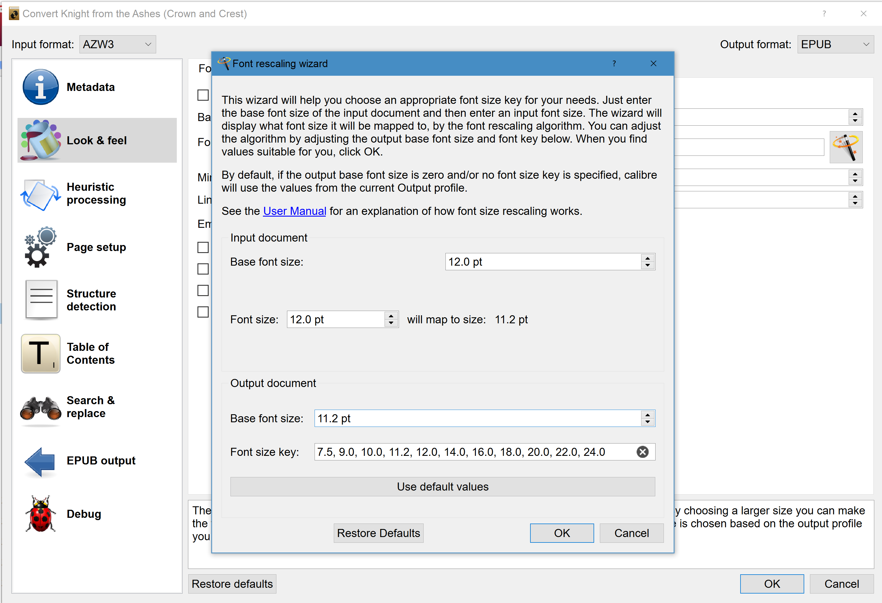

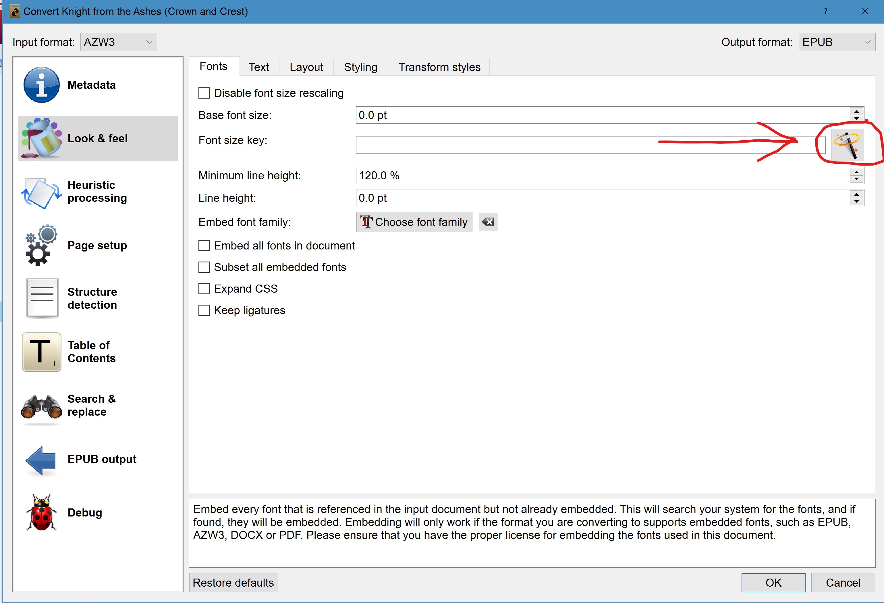

I guess I need to learn how to do that as I really like the Glowlight screens. Do you use Calibre?
Yes.
First, I strip out the default font size if it's anything else than 1em. This I do in the editor. I don't know how the size embedding works if you don't do that.
The embedding itself I do while converting. First, I enter the font size key (click on the button shown on the first picture). I enter the 11 values in the field Font Size Key (the second picture) and change the base font size from 12.0 to 11.2 (the field named Base Font Size above the size key field). Then I click OK. I also embed a custom font after this.
Your favorite values and base font size are almost certainly different than mine. It took me some experimenting before I found the right one. I use the 5th size from the left on my Nook (it's 7.8'', so you probably want a smaller value) on the firmware 53.0.36 (I think they changed font sizes in the next firmware update, so I didn't update my Nook).
