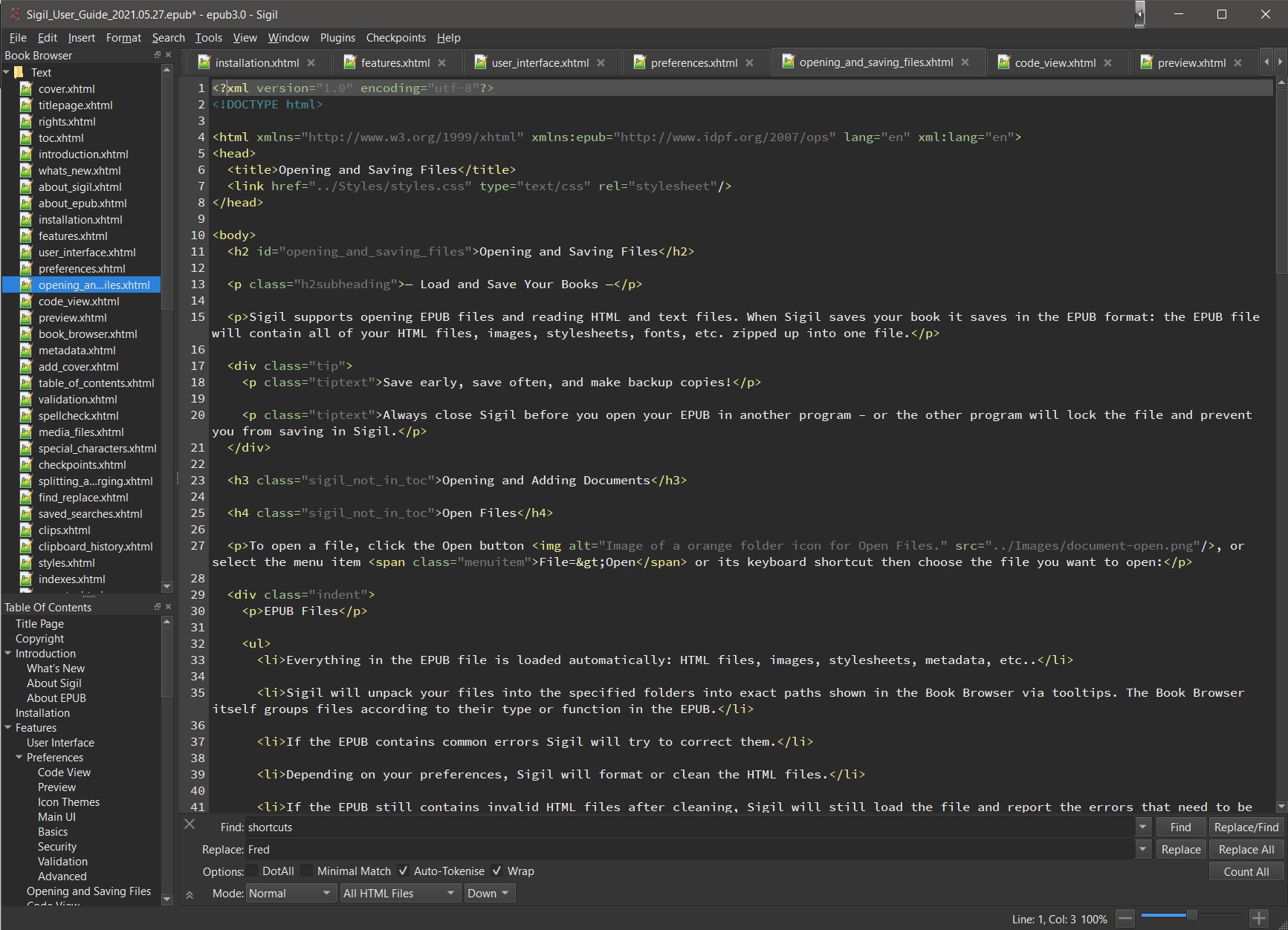

FWIW: there's a shortcut for Close other tabs, I have it as Ctrl+Alt+W, not sure if that's a factory or custom setting.
OT: I don't get shortened names in the CV tabs. I see this with every html file of user guide open
Name:	Screenshot 2021-08-31 080757.jpg

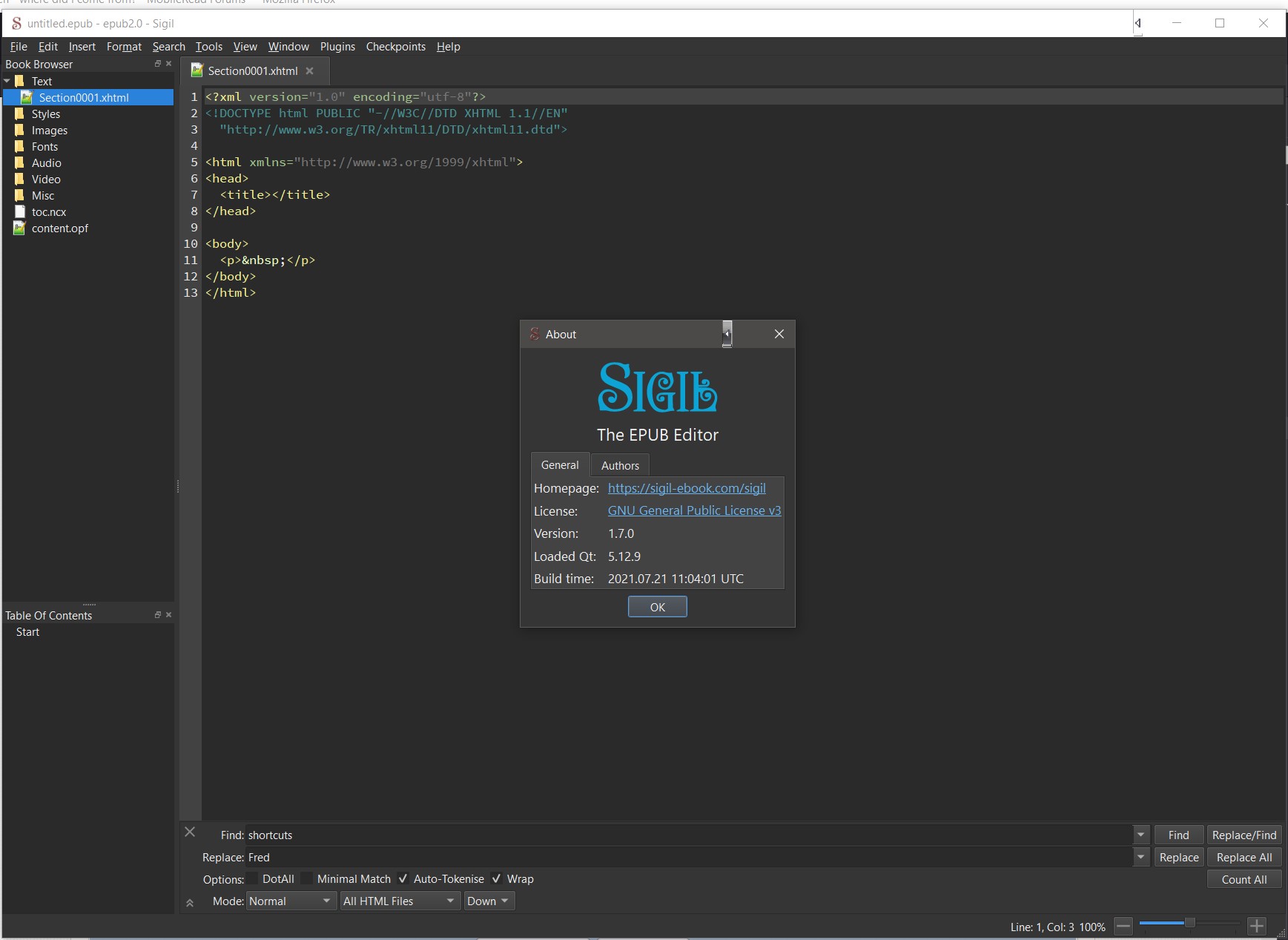

Which version of Sigil are you using today?
Name:	Screenshot 2021-08-31 083729.jpg

Just checking. You had said something about going back to an earlier version recently. I just know the eliding of tab titles has gone through changes in the various Qt versions.

No worries - I installed 1.0 on another VM, so its there when… if I need it.
