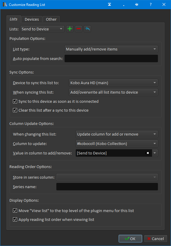

Step #4 might be invalid if you don't call your reading list exactly "Send to Device." So just fix it. If you haven't already got that reading list, here's my settings:
Name:	2021-08-15 20_43_52-Customize Reading List.png

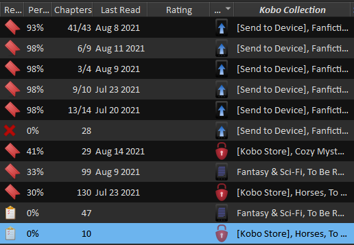

If you want to get extra-fancy, you can use custom column icons to override the standard checkboxes/red x's. I also do it for my #read column.
Name:	2021-08-15 22_36_59-Window.png
