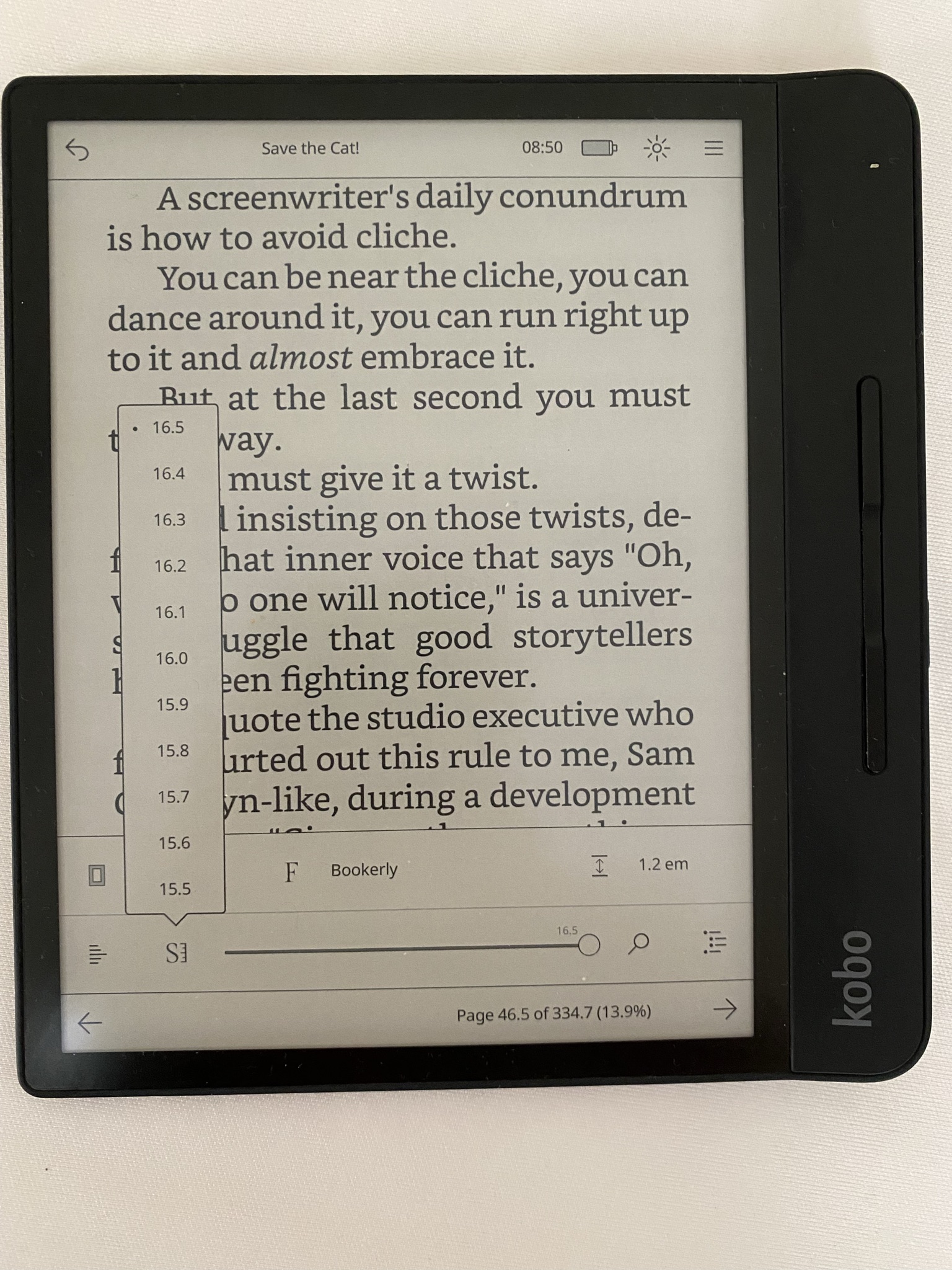

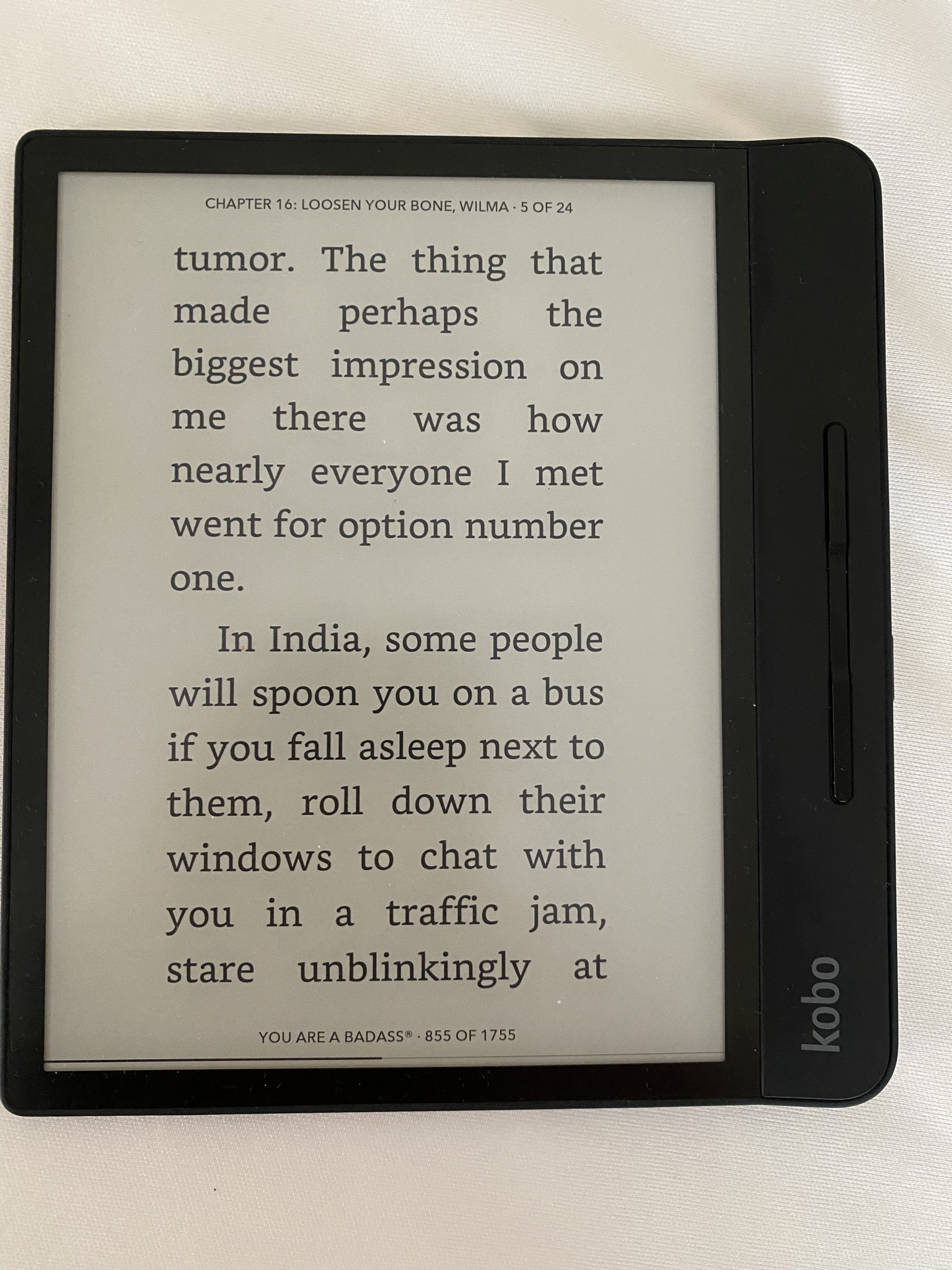

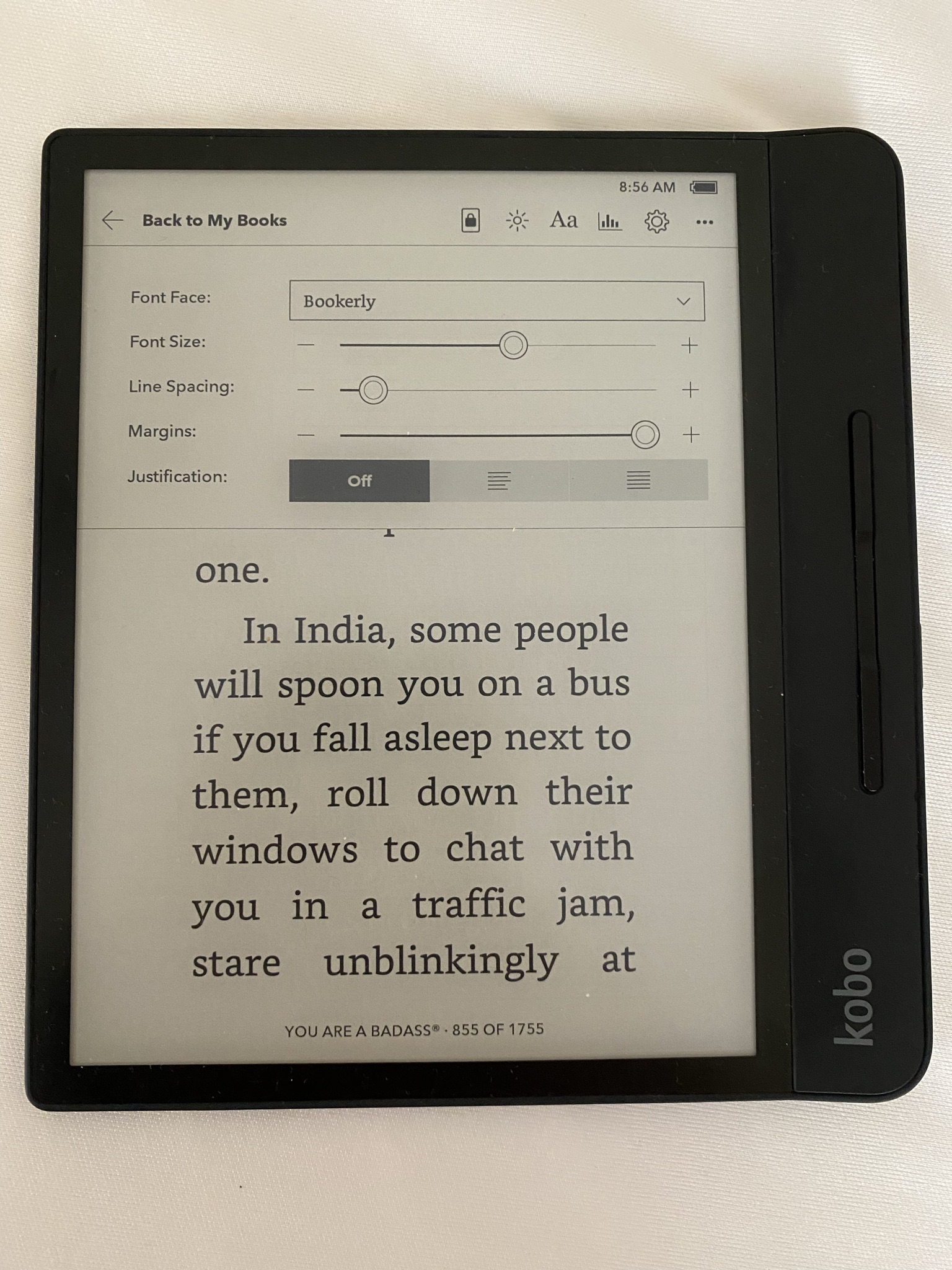

Sorry for the confusion, I meant that I needed the margins around the text to be larger so the text column is narrower (see below image).
Originally Posted by baskerville View Post
What font size (in points) would you like to be able to select?
I’m not sure what point size would be ideal BUT below is an image with my ideal font size and margin width with Nickel, in contrast with what I can get in Plato within the UI. The size in the stock Kobo image is at half of Nickel's font size slider (it's ginormous on the biggest setting).
ID:	188706   Click image for larger version
ID:	188707   Click image for larger version
