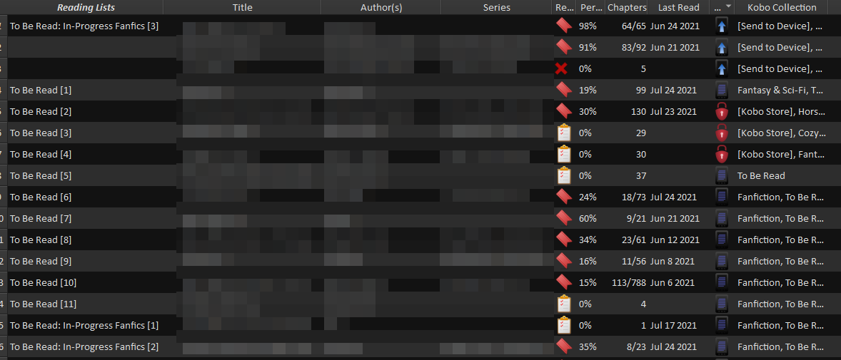

That's odd, because I never use the 'view reading list' option. I just switch to my on-device view, which shows that stuff in the columns.
(The column with the ellided label is 'On Kobo.' I make extensive use of custom icons for it.)
Name:	2021-07-24 17_07_55-Window.png
