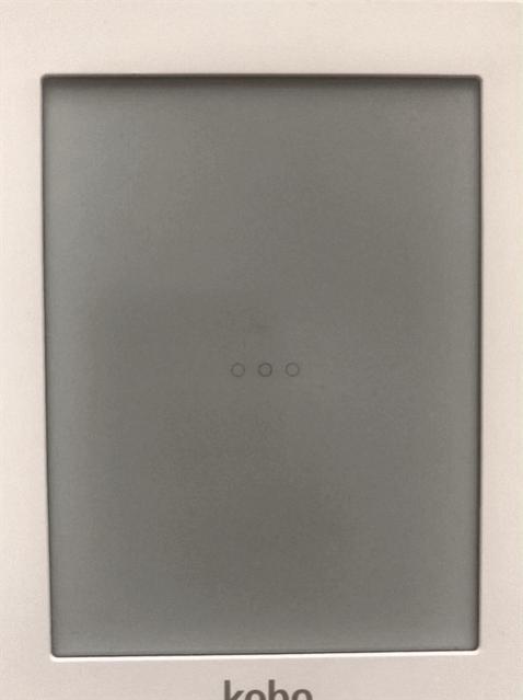

Hi guys, I've been stuck with my Kobo Mini in an update loop. There are three dots on the screen changing and green light flashing for twho hours now. Is there a way how to get Kobo mini from this state?
MyKobo Mini has been restet to factory defaults and I was unable to to make i work as a reader again. So I've found an update image but after applying it kobo has been stuck.
Thanks for your advices.
M.

Screenshot of the Kobo Mini
I'm not sure what you mean by an "update image". If a factory reset got it to this state, then it there is probably something wrong with the SD card. I have sent you a PM with link to an image for the Mini. I would suggest restoring the image to a new card. You can use a larger card, but, anything larger than 16GB might not work. You can then recover the rest of the space once the device is working.
