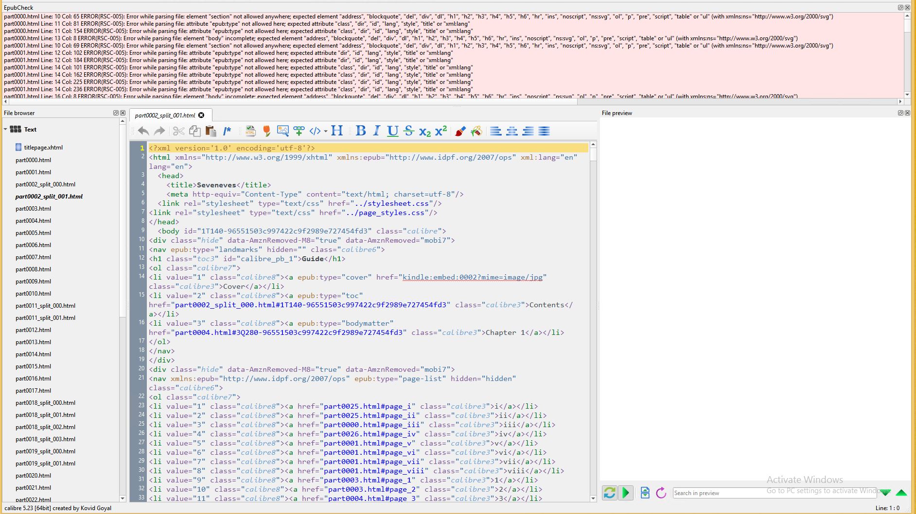

I installed epubcheck and after a bunch of poking around to figure out how to run it, it didn't seem to do anything. When I went to 'Edit' the book, then 'plugins', followed by 'Run epubcheck', it seemed to indicate that it was running. But nothing after that.
So I looked at the files. As I'm sure you're aware, there are basically a bunch of HTML files inside an epub. Looking at what was in this file, there was a 'part0002_split_000.html' and a 'part0002_split_001.html'. The 'part0002_split_000.html' seemed to be the proper and complete TOC when viewed in the 'file preview', but the 'part0002_split_001.html', viewed in the 'file preview', was blank. The next file, 'part0003.html', was the beginning of the book. So on a 'whim', I deleted 'part0002_split_001.html' and saved the book, then sent it to my PRS-T1, since that's the one that REALLY didn't like the error. Works perfect now (or at least seems to).

@cougar281: Did you see a window similar to the one on the left side of the attached image (I keep epubcheck docked with file preview and live CSS, your location will vary.
I'm not exactly sure what you're referring to, but if you mean the file browser/test and all of the html/xhtml pages below it, yes. But I did not get the 'Check Book' window above it or the 'EpubCheck' Window to the right.
I do have Java 8 update 221, both 32-bit and 64-bit installed on my machine.
I think I resolved the issue with my epub by deleting the 'part0002_split_001.html' file from it, but for grins, I installed just the latest version of java on a VM with Calibre and installed the plugin, and it worked - so either having both the 32-bit and 64-bit versions of java confused things, or the ABSOLUTE latest version is required (Java sucks so bad.... I cringe any time it's required). Whatever the case, it seems there are a 'few' errors. From skimming it, it seems pretty much the entirety of 'part0002_split_001.html' is one big error. But the list is pretty long... So I clicked 'tools' > 'Fix HTML - All Files' and saved the file, but no change on the device. Maybe I just didn't do it right, but as just removing the 'part0002_split_001.html' seems to have fixed it, might just stick with the version where I deleted the 'part0002_split_001.html' file... Oddly, out of all the epub books I have, mostly native epubs but some converted from other formats, this is the ONLY one I've had any issue with.
