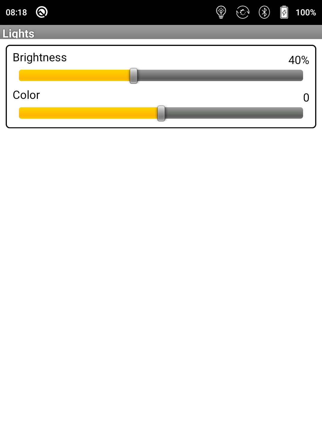

Ok, here's a bit of something.
This will not remap stock brightness sliders in other apps as I have to work out how best to avoid an endless loop.
The Onyx has an enormous dead zone on the low end of brightness. I'm trying to compensate here. This should give you full range.
Do not unzip the file, only rename it Lights-Alpha.apk
Edit: Stop the presses!
Yes, you can try out this if you like.
I've figured out how to get a real smooth continuum on the color temperature.
Tomorrow's version will be better.

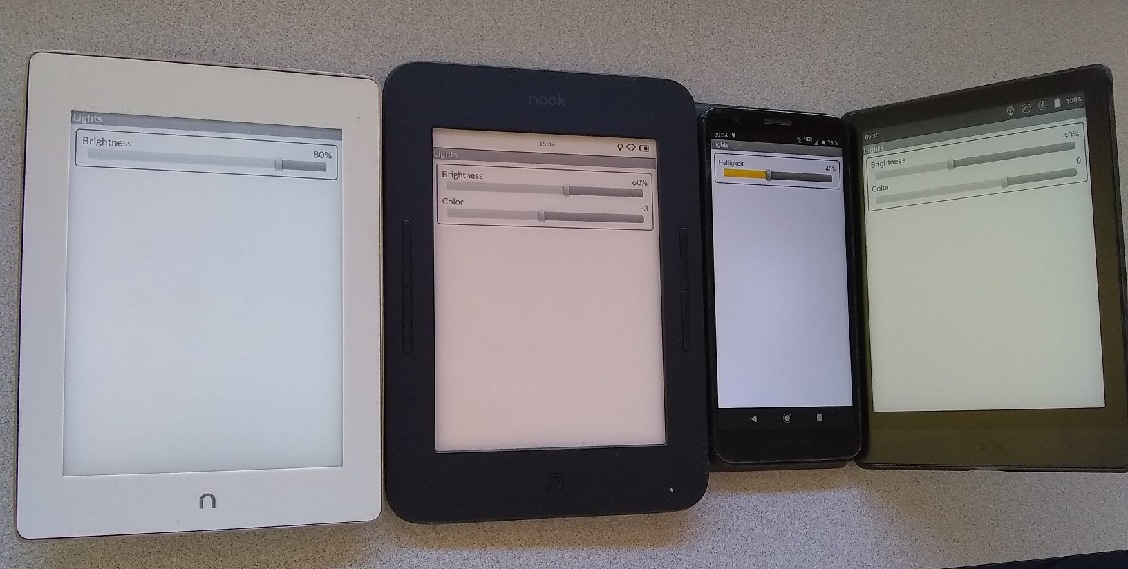

So, here's an updated version.
I still have not added the ability to use a generic brightness control in some other app.
I have fixed this to use the correct exponential curves in an LM3630A.
I've shifted the (supposedly neutral) zero point to 2/3 along.
You still have access to complete warm to complete cold with hopefully a linear range to your eye.
And I have it save your color preference when the lights are fully off (and it can't determine your color preference from the values).
Not a biggy, but if you tried running this app on your cell phone or something that didn't actually have red/blue LEDs it might have written some settings.
That's not a killer, but it will cause the later version to think that you actually do have red/blue.
Do not run these commands on a Poke.
Only run these commands on a non-Poke if you tried the first version.
$ settings delete system screen_cold_brightness
$ settings delete system screen_warm_brightness
Yes, you can run this version on your cell phone (if you want).
It should show only the Brightness slider and will work normally.
Edit: With a few more tweaks (not yet posted) it does B&N Glow3 too (although the stock pulldown is not so bad).

I only read on my Poke3 nowadays, but if someone has a question on something I do own, I can just reach into my crate of ereaders and dust one off.
Last night in the dark I found that I could barely read with the brightness set at 25%.
So, you're saying that 5% is seriously too bright?
Those commands were trying to figure out if the Poke2 uses the same LM3630A LED driver.
Then there is also the possibility that they are using that in linear mode (instead of exponential).
I can write code to poll the IC for what mode it's in, but you need root for that.
You could look through /sys/firmware/devicetree, but you need root for that.
If somebody has a rooted Poke2 we can try that.
Of course you could do it the easy way: extract the boot image, extract the kernel from that, detach the device tree from that, decompile it.
Edit: Well, this works fine. Anybody have a rooted Poke2?

I apologize for any misunderstanding. I have a Poke2 that has become my favorite reader. I also have an original Poke. The original Poke has both white and red LEDs but has only one slider for the light control. When the slide is centered, the light is effectively off. Sliding to the right activates the red lights and sliding to the left activates the white light. There is no mixing possible with this set up.
The Poke2 is fine. I suspect very similar to your Poke3 as far as the software. Poke2 = android 9, Poke3 = android 10 and micro usb vs. usb C. The lights should be the same.
I was trying to get some lighting mixture introduced into my original Poke. That's the one where 5% on your app is quite bright.
I wish I could help out with some of the setting commands you mention.

Oh, ok.
So I take it that the Poke2 works fine and that the 5% is barely on.
And that the Poke1, while too bright does exhibit actual mixing of red/blue?
In any case, anybody with other Onyx who feels inclined to check those commands that I mentioned above or has a rooted device to run some test software might solve some of my curiousity.
