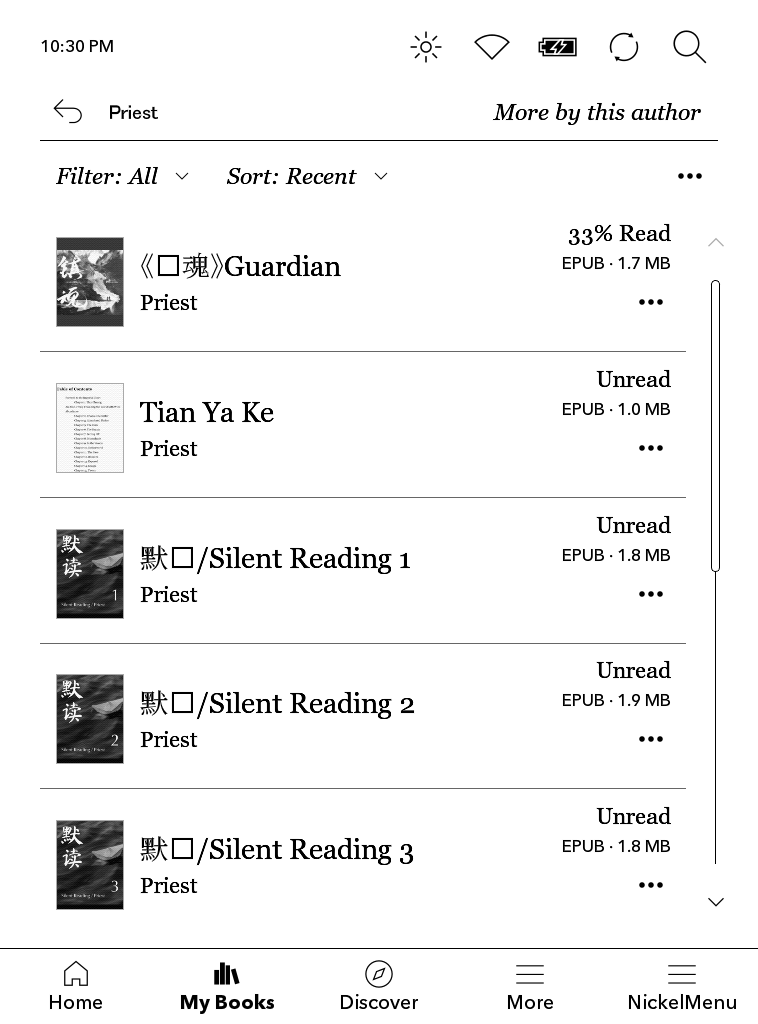

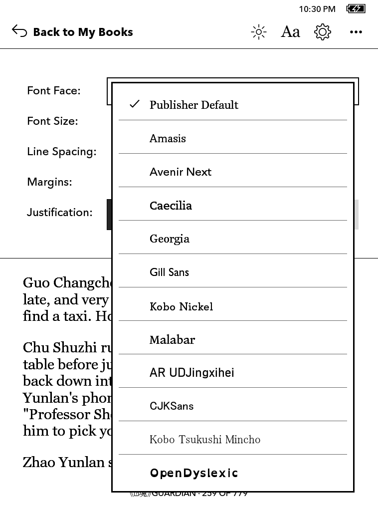

Anyone have any luck overwriting the CJK fallback fonts? I'm getting steadily more annoyed by the missing Simplified Chinese characters in the titles of some of my books (see screenshot) and decided to try to do something about it.
What I tried:
kobopatch.yaml
  # Fonts
  src/cjksans.ttf: usr/local/Trolltech/QtEmbedded-4.6.2-arm/lib/fonts/KBJ-UDKakugoPr6N-M.ttf
  src/cjkserif.ttf: usr/local/Trolltech/QtEmbedded-4.6.2-arm/lib/fonts/KBJ-TsukuMinPr6N-RB.ttf
nickel.yaml
Add title fallback fonts:
  - Enabled: yes
  - Description: |
      Add CJK fallback fonts for titles
  - BaseAddress: 0x14C8B81
  - ReplaceZlibGroup:
      Replacements:
      # Change the replacement values to your desired width (I've made it half the default width as an example).
      - {Find: "font-family: Georgia;", Replace: "font-family: Georgia, CJKSerif;"}
      - {Find: "font-family: Avenir;", Replace: "font-family: Avenir, CJKSans;"}
  - BaseAddress: 0x14C9E23
  - ReplaceZlibGroup:
      Replacements:
...where CJKSans and CJKSerif are two fonts I cobbled together out of Microsoft's stock Japanese and Simplified Chinese fonts. The patches work and apply properly (side note: do not attempt to add CJK glyphs to Georgia and patch that, the update fails and I had to factory-reset my Glo. Probably a filesize issue), but I don't see any changes in the UI and while CJKSans now shows up in the list of available fonts, CJKSerif dosn't and instead Kobo Tsukushi Minsho does (see second screenshot), which makes me think it's not being overwritten and still being used as the fallback somewhere.
I have a Glo and am happy to pop open the case and mount the internal SD card to investigate if it helps at all.
ID:	187832   Click image for larger version

You only change the filename without changing the font name in the Font Info. Therefore, nickel does not see it.
I once added missing glyphs to Georgia (not Japanese alphabet characters) for the sake of testing, and it worked great.
Semwize is offline   Reply With Quote
Old 06-23-2021, 05:15 PM   #740
momijizukamori
momijizukamori doesn't littermomijizukamori doesn't littermomijizukamori doesn't litter
Posts: 14
Karma: 210
Join Date: Sep 2018
Device: Nook Simple Touch (rooted), Kobo Glo
Yeah, but if it's being overwritten, it shouldn't be showing up in the font-list, no? Like UD Kakugo no longer shows up and CJKSans shows up instead - but CJKSerif doesn't.
And like I said, I think with Georgia it was a filesize issue - so if you were only adding a handful of missing glyphs it was probably fine. But adding the thousands of CJK glyphs (well, CJ, mostly, as I don't need hangul support) makes the filesize go from like ~200kb to ~12mb. My two modified fonts are much closer (within a mb or two) of the existing CJK fonts which is why I went with overwriting them.
momijizukamori is offline   Reply With Quote
Old 06-23-2021, 06:04 PM   #741
Semwize
Semwize ought to be getting tired of karma fortunes by now.Semwize ought to be getting tired of karma fortunes by now.Semwize ought to be getting tired of karma fortunes by now.Semwize ought to be getting tired of karma fortunes by now.Semwize ought to be getting tired of karma fortunes by now.Semwize ought to be getting tired of karma fortunes by now.Semwize ought to be getting tired of karma fortunes by now.Semwize ought to be getting tired of karma fortunes by now.Semwize ought to be getting tired of karma fortunes by now.Semwize ought to be getting tired of karma fortunes by now.Semwize ought to be getting tired of karma fortunes by now.
Posts: 931
Karma: 275656
Join Date: Jun 2016
Device: Kobo
I don’t know what these fonts are, haven’t come across them. If they display well the Latin alphabet, try replacing Georgia with one of these fonts. By changing the filename and font name in info.

I have applied the header/footer font patch, so now I have the book title and chapter in Georgia but the page number, X of Y, is still in Avenir.
Is there a way to make all in-book header/footer items the same font?
And, I know this is probably impossible, but, is it possible to add pinch to zoom for changing font sizes? I know it's available in KOReader (iirc) but I don't like using KOReader.
