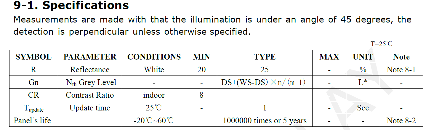

The documentation says the CR is 8. Compare to eInk Pearl at 10 and eInk Carta at 15. The white reflectance shows as 20 min and typ 25. By comparison, an eInk Carta shows 74% minimum. This may be affected by testing methodogy differences.
And note that the Good-Display numbers are for the B&W screen with no front light, touch, colour filter or other layer in front of the screen.
