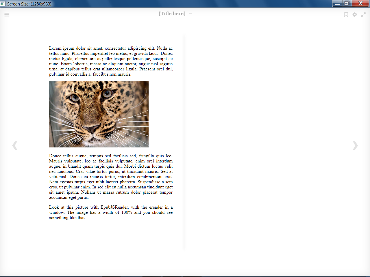

Look at this picture with EpubJSReader, with the ereader in a window. The image has a width of 100% and you should see something like that:

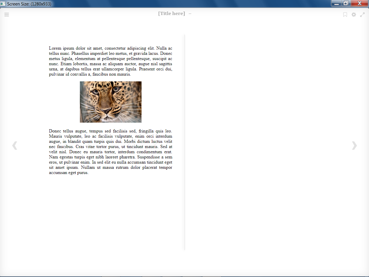

Now look at the same image but with the ereader at a full window:
As you can see, the ereader doesn't respect the declared width of the image when its width is 100% and when someone is reading in a full window.

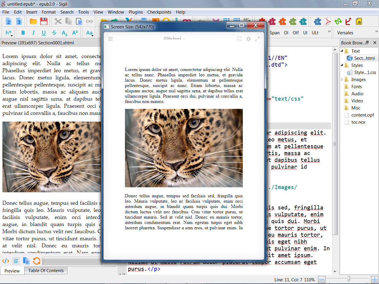

Now see the same case but with a image with a width of 50%:
ID:	187629 Click image for larger version
With a image of 50%, EpubJSReader respects the size of the image (both, in a half or a full window). Below I attach the respective epub. Could this behaviour be fixed?
