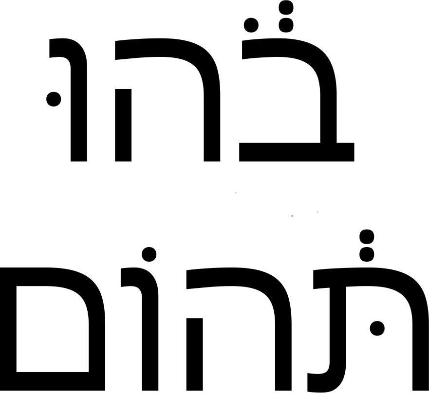

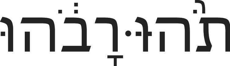

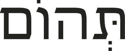

Actually, I think they may have botched the ebook slightly.
Originals:
LibreOffice Writer (v7.1.3.2):
1st word's alt text is definitely missing the 2nd chunk.
In 2nd example, LibreOffice has 2 dots above. In original image, it's two dots below.
Unsure which rendering is correct though, since I don't read Hebrew.
