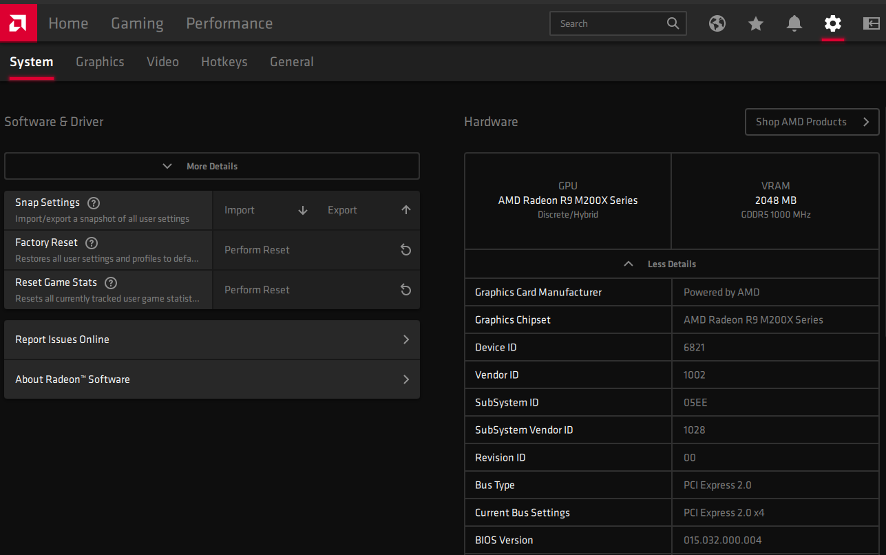

A while back, after a Window update I assume, I got a Radeon Software icon in my system tray. I've never clicked on it until now. When I do, it looks like this.
The best I could do to check my laptop manufacturer for what video hardware is installed was to go to the dell site: https://www.dell.com/support/home/en...-17r-5737/docs
The manual for my 17r-5737 - https://downloads.dell.com/manuals/a...uide_en-us.pdf - doesn't seem to be much use for what we're talking about.
I don't think I should waste your time much more. Perhaps my laptop is just old and decrepit?
Could I try disabling either "AMD Radeon R9 M200X Series" or "Intel(R) HD Graphics Family"? As I say, I don't know which one is being used at the moment.

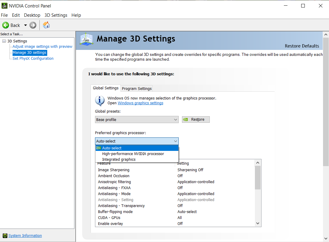

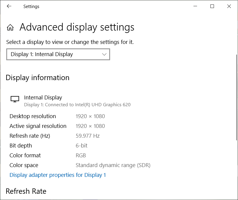

Much like my laptop, it can use either or both depending on how your system in configured. If you right click on a blank spot on your desktop, select Display Properties and then Advanced display settings, you can see what driver your display is connected to. I've attached some images from my laptop as an example.
If you are using the laptop display, you should be able to disable one of the drivers to force the other to be used. Or this may be an option in the Radeon control panel if it is one that is customized for your laptop. I know on my laptop, I need to do any display driver updates from the Lenovo site unless I want to have "interesting" results and the customized Nvidia control panel allows me some control over which video chipset is active.
Name:	Advanced display Settings.png
ID:	186874   Click image for larger version
Name:	Nvidia Control Panel.png

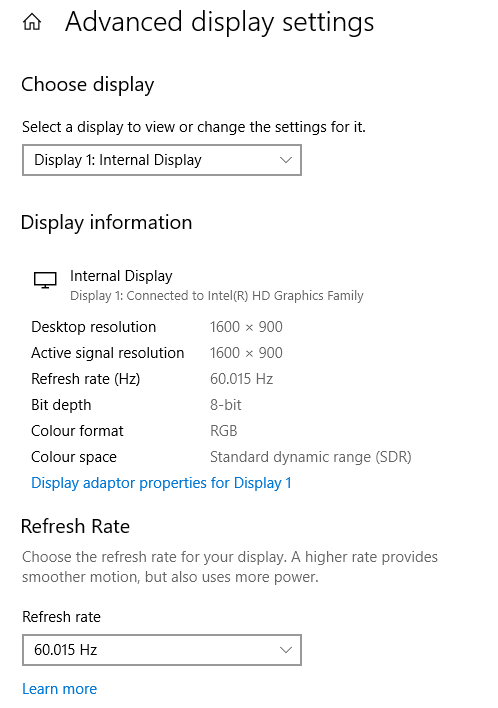

Thanks, David.
I've attached my Advanced display settings.
I notice you, like me, are using the Intel Graphics thing. Do you not use the Nvidia one? And if you don't, are you still recommending that I do (well, Radeon in my case)?
Is updating the drivers a separate thing? I think you're just recommending I update my drivers in case that's the problem?
I'll try to choose the Radeon one now anyway but in case you're about now, hopefully you could reply to this first and then we can move forward in stages. [I'll check for replies much more frequently than I just did.]

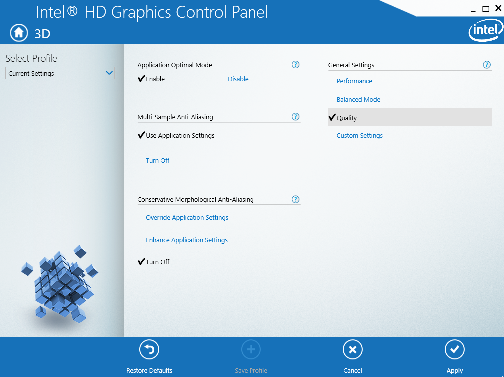

EDIT: Before I do anything else, I went into the Intel 3D settings (beacuse you did in your Nvidia settings - I had no idea what 3D settings were for or that they would have anything to do with calibre). I saw that General Settings was set to Balanced, so I changed it to Quality. I wonder if this might help in itself. (I don't have battery in my laptop because it broke so I don't care about power saving really.). I've attached that screenshot too.
Name:	advanced display settings1.png
ID:	186876   Click image for larger version
Name:	Intel 3D settings1.png

I can't for the life of me see how to do this in the Radeon Software panel.
It looks like I could disable the Intel device in Control Panel. See attached. Is this how to do it?
The Nvidia driver is more capable than the Intel driver however it is also uses a lot more power. I only use the Nvidia chipset when I need the performance.
Much appreciated; calibre does seem pretty slow to load books and also to close the window after I've edited metadata.
At one point in time, if i forced the Nvidia chipset in the 3D settings, it also set the Nvidia chipset as the default for my standard 2D Windows desktop. I reported this as a bug and the bug was reported as having been fixed but I've never tested that. One of my co-workers had the same issue on his HP laptop which she aggravated by updating the two video drivers separately.
