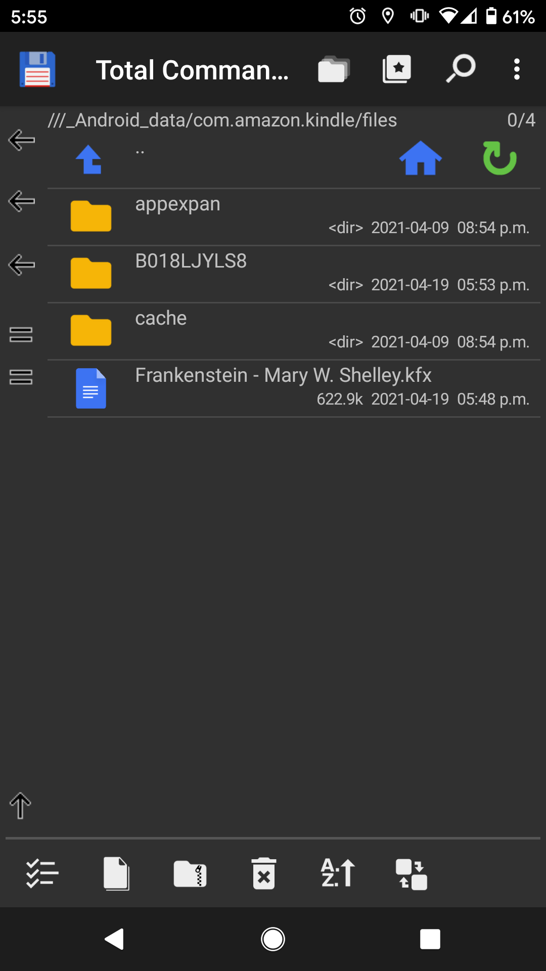

I need help with Xray on kfx files for andriod

Originally Posted by Pirate4Life View Post
I tried using XRAY on KFX files on android with no success. Please can someone walk me through the process of adding Xray on KFX files for android? I have tried the process stated on the main page for AZW4 files on android and it worked can't seem to replicate the same results with KFX files.
Seemed to work for me. I'll attach an example of the files in their destination.

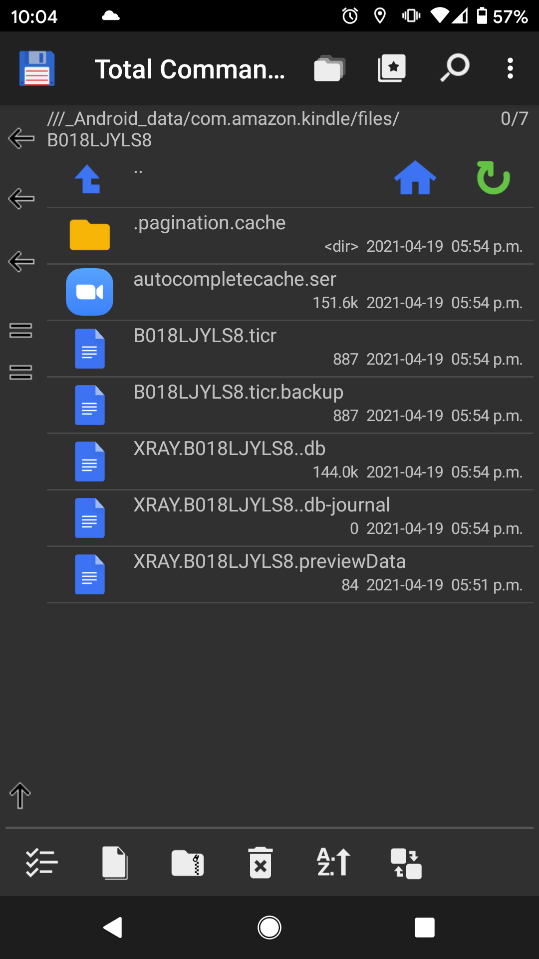

Please can I see what is inside the folder (the one with the book ASIN number as its name)
This is what it looks like now (after the Kindle app added more stuff).
When I copied it over, the only files that were there were XRAY.B018JYLS8..DB (the extra dot is intentional) and XRAY.B018JYLS8.previewData, the files that were creating with the Build for Android setting enabled.

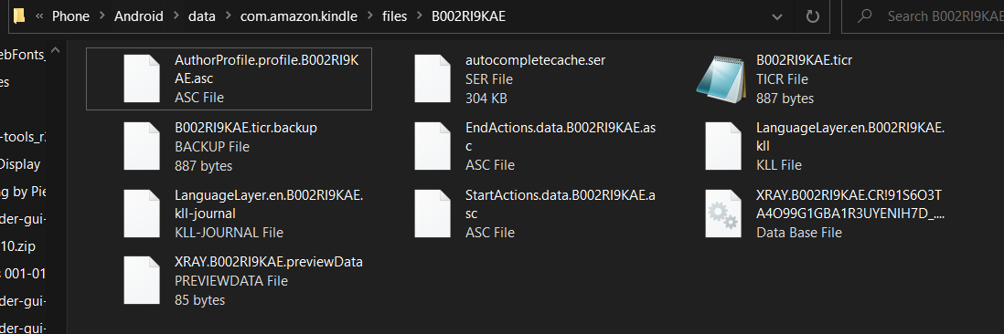

I don't know what I am doing wrong at this point.
I see that your XRAY.db file has a dbname_guid section in the name while mine didn't, so I'm wondering if that's the issue.
You could try changing the name to XRAY.B002RI9KAE..db and see if that works
Otherwise, do you mind zipping up the kfx and stuff from your phone and sending me a PM with a link (mega or google drive or whatever), and I can investigate?
Looks like the copy you used to generate the X-Ray is different than the one that's on the phone, like it's been run through Calibre another time or something.
The filename it's actually looking for is XRAY.B002RI9KAE.CR!TO8MCGKBQ14Z9IM4T8BCBWPSPYCN.db, but the one on the phone is XRAY.B002RI9KAE.CR!91S6O3TA4O99G1GBA1R3UYENIH7D_.d b.
If you just rename the file it should work, though there's a chance the highlighting could be wrong depending on if the book's content has changed at all.
Note that the underscore shouldn't actually be there, that's an issue I'll fix in the next version (I think it used to be required in an older build of the Android app or it wouldn't have worked in the beginning).
