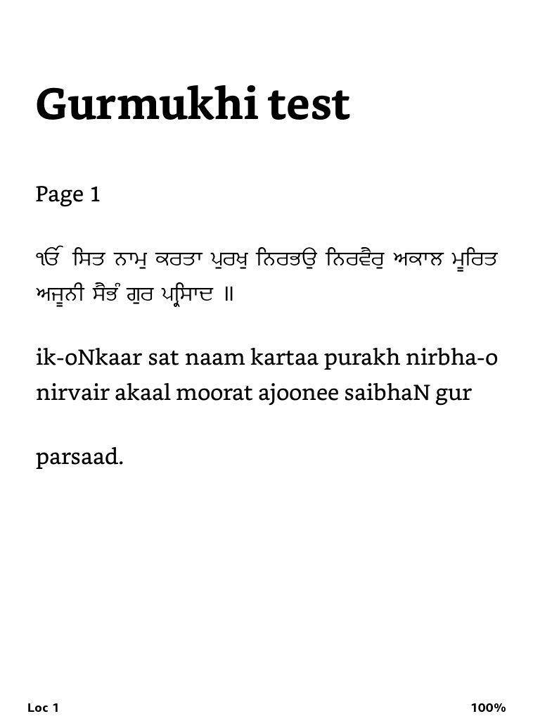

Originally Posted by KamSingh View Post
<p class="calibre1">Page 1 </p>
<p class="calibre1 gurmukhi">ੴ ਸਿਤ ਨਾਮੁ ਕਰਤਾ ਪੁਰਖੁ ਿਨਰਭਉ ਿਨਰਵੈਰੁ ਅਕਾਲ ਮੂਰਿਤ ਅਜੂਨੀ ਸੈਭੰ ਗੁਰ ਪਰ੍ਸਾਿਦ ॥ </p>
<p class="calibre1">ik-oNkaar sat naam kartaa purakh nirbha-o nirvair akaal moorat ajoonee saibhaN gur </p>
<p class="calibre1">parsaad. </p>
If you own a Kindle model that supports AZW3 or KFX files, you don't have to embed any fonts since current Kindle models support all major Indic languages out of the box.
(The screenshot shows the KFX version of your HTML code without any embedded fonts.)
