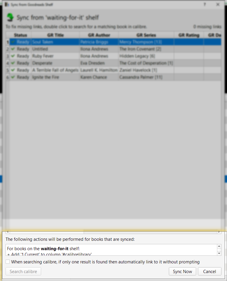

I am talking about the box in the pic I have attached.
I am not sure where it is in Dialog, however, I can stretch the box anyway (as you can see in the pic) but that little bit below stays shrunk down like that.
