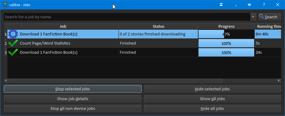

Any idea why this sometimes says two stories downloading? it usually happens when I am running an update always to fix a title page.
Also: Without feeding a custom category into a temp column, is there any way to see what it outputs? I'm trying to troubleshoot a tagcategory issue (fics keep ending up in Fanfiction.Other rather than Fanfiction.Disney and I'm not sure what step it's breaking down).
Name:	2021-04-14 04_55_48-calibre - Jobs.png
No idea. I would guess duplicate story URLs? Can you duplicate? If so, how?
