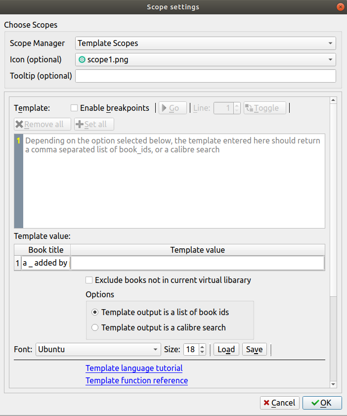

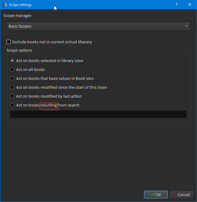

Old 04-11-2021, 08:07 PM   #520
ownedbycats
Custom User Title
ownedbycats's Avatar
Posts: 11,837
Karma: 83109135
Join Date: Oct 2018
I found a tyop!
Name:	2021-04-11 20_59_28-Scope settings.png
