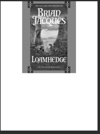

Question: Is there a way to upload a cover to a book without a match in the library? Some of my library books do this crap:
Name:	2021-04-04 05_35_35-Window.png
I've just been matching dummy books to fix this, but is there a better way?
Attachment 186384
No there isn't. Personally for books I borrow, I add an empty book to my library so that I can track what I have read. If these are sideloaded from ADE, then it will work. But, if it comes from Kobo, the cover could be updated each time the device syncs.

It's from ADE. I'm not sure why it happens with some library books but not others. And a few just didn't show any cover at all, just the title.
Attachment 186384
What you need to do is try to find a hi-res cover and fix the code to display it full screen.

It's a library book. I can't fix the code without breaking the DRM and it's not my copy to break the DRM on.

I just downloaded a copy from Overdrive and it displays OK in ADE 2.0.1. I've not tried it on my H20.
It depends on the first page of the book. For epubs, Kobo renders the first page of the book and uses that for the cover. Some books have a good first page, others do not.
Isn't that the same with KePub?

No and you should know that. It has been discussed many times. For kepubs, the cover image is marked in the OPF. That image is extracted and doesn't have to be used anywhere else in the book.
