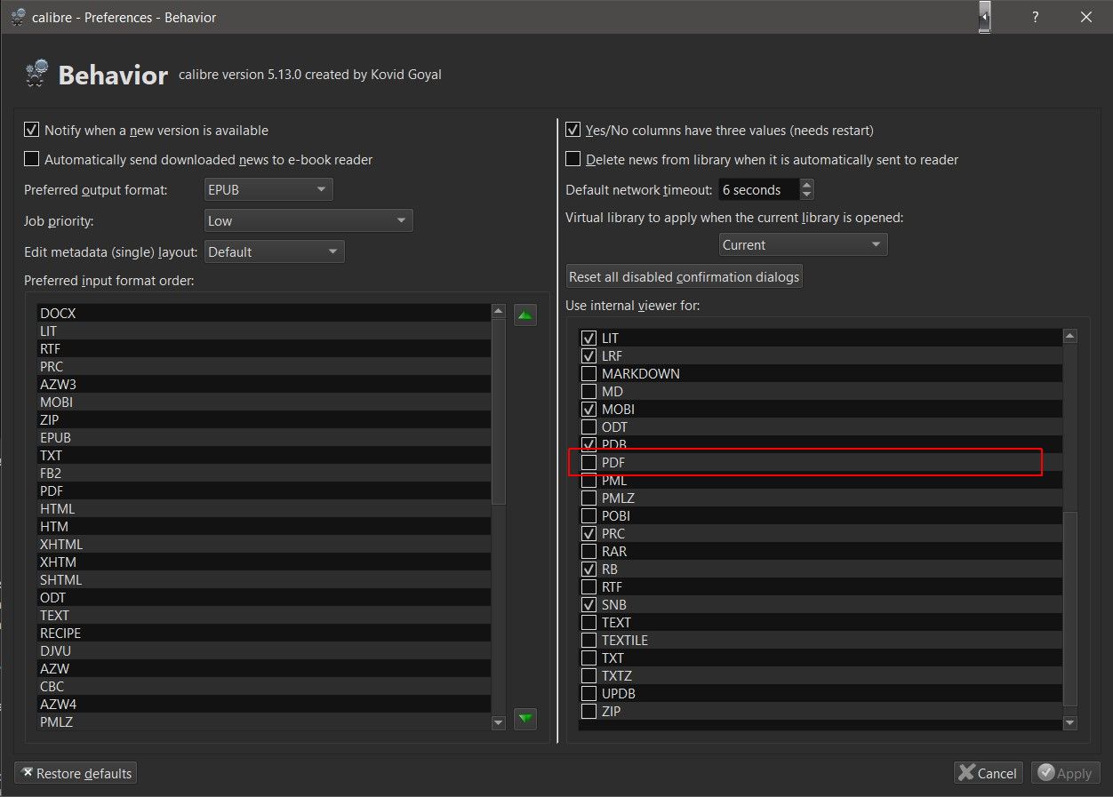

Hello, I have the same problem of mirrored text. I could not find where are Preferences-Behavior in Calibre 64bits.
Ctrl+P then:

Thanks! It was unchecked by default. Now I am converting the PDF into EPUB, I will see the result in half an hour.
