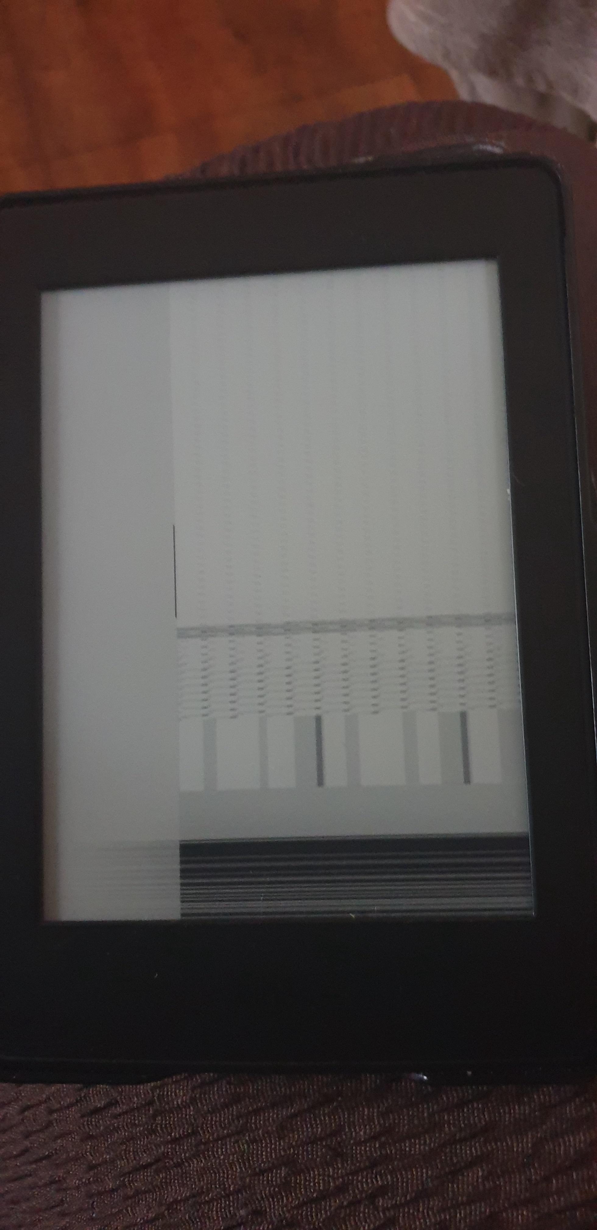

have time workig with screensavers etc ok, ( with some frezzes) in this time my screen show this and cant restore have all time show this in rebot, is pw3 have way to restore plz?
Have 2 pw3 with same problem
thoriki is offline   Reply With Quote
Old 04-11-2021, 09:42 PM   #545
thoriki
thoriki began at the beginning.
Posts: 17
Karma: 26
Join Date: Jan 2020
Device: kindle paperwhite 7th, and 10th
Anyone can help me please?
