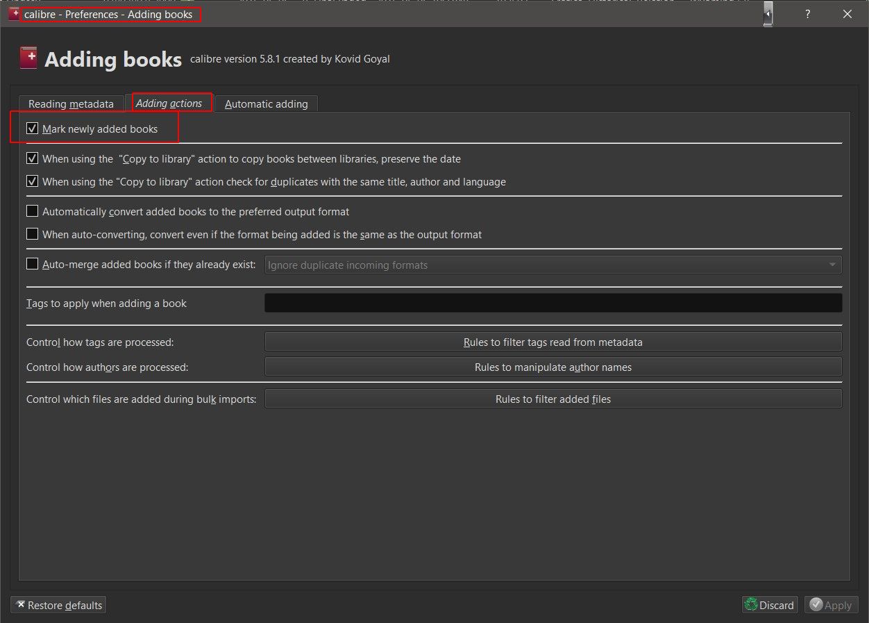

Originally Posted by manawydan View Post
Hm. Ok.
But there used to be a mark when a book had been added to RL. If it was/is not add-on specific it must have been part of the main calibre software?
I guess I should ask in the main calibre boards then since it has nothing to do with the plugin nor is there a way the plugin can do it.
This has nothing to do with reading lists as such, but if you set Mark newly added books then… viz:
Name:	Screenshot 2020-12-29 195750.jpg
Then show and select all marked books and add them to the default reading list. For me that would be Ctrl+Shift+M and Ctrl+Shift+R - but they maybe custom shortcuts.
The Marks will disappear if you clear them, exit calibre or switch libraries.
