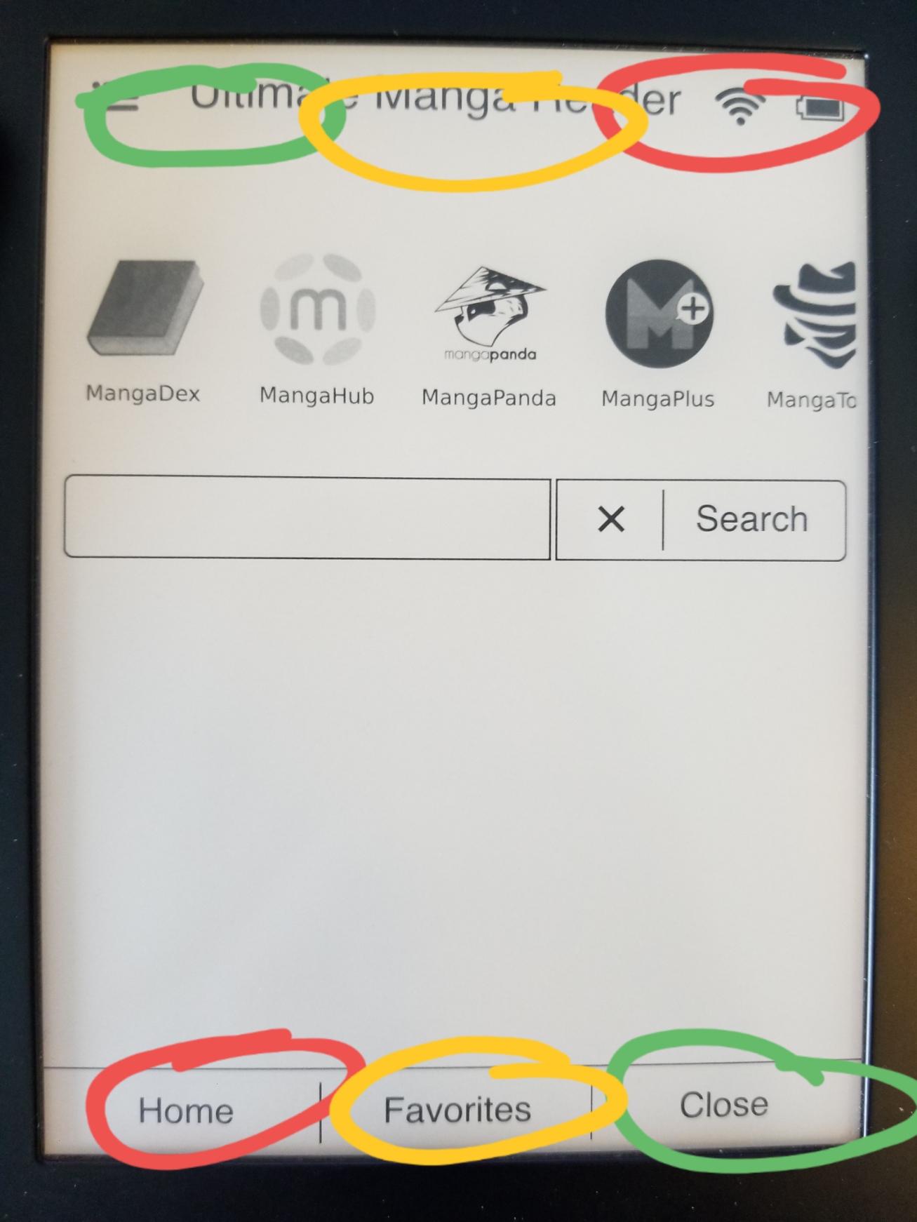

Hi OfficerAction,
I tried out the new release (2.10.1) on my Kobo Clara HD and the touchscreen input seems to be messed up. I found tapping the top of the screen actually activates the buttons at the bottom in an inverted manner (see attached image)
Hope this helps with debugging.

I was able to fix this on my Clara HD using the line
export QT_QPA_PLATFORM=kobo:touchscreen_rotate=90:touchscreen_invert_x=0:touchscreen_invert_y=0:logicaldpitarget=108
in ultimatemangareader.sh.
