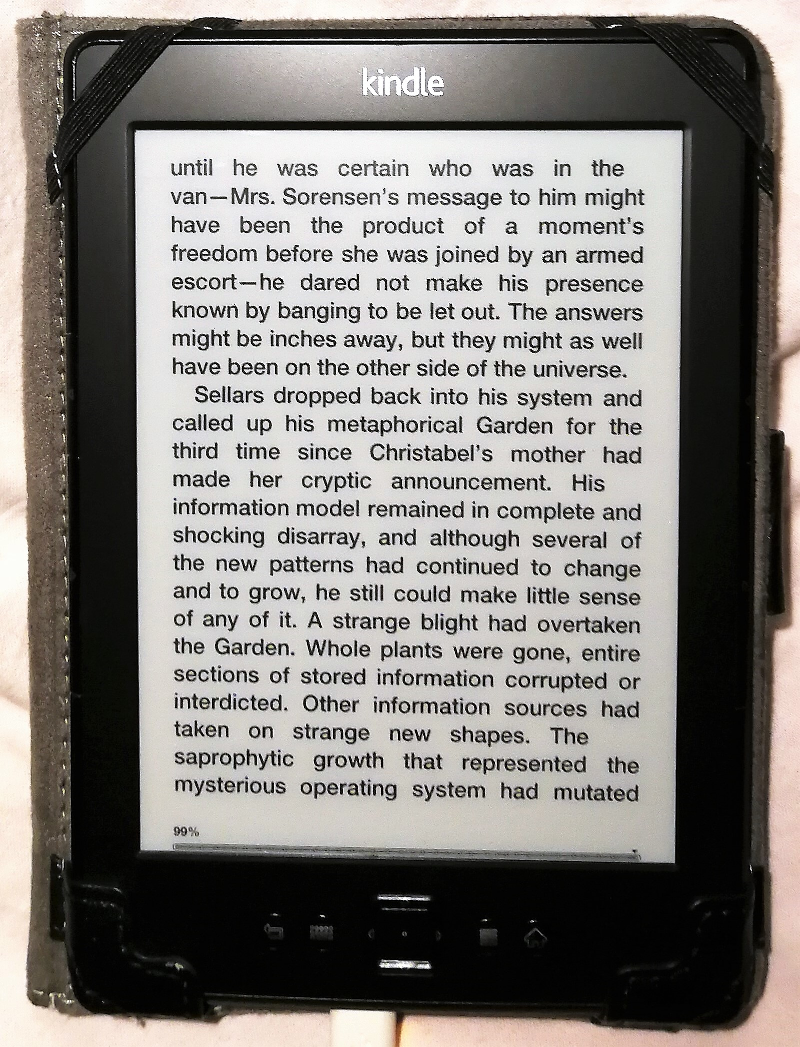

Given that you got it cheap, I would ditch it rather than start to mess with replacing the screen. I have the same Kindle model from years ago and in no way does it display either text or images like yours does. Sorry to say this but your screen looks thoroughly messed up.

The text on a normal Kindle screen, even if the Kindle is as old as yours, never looks this washed out.
Edit: here is the photo of the same model I took a year ago, just in comparison.
