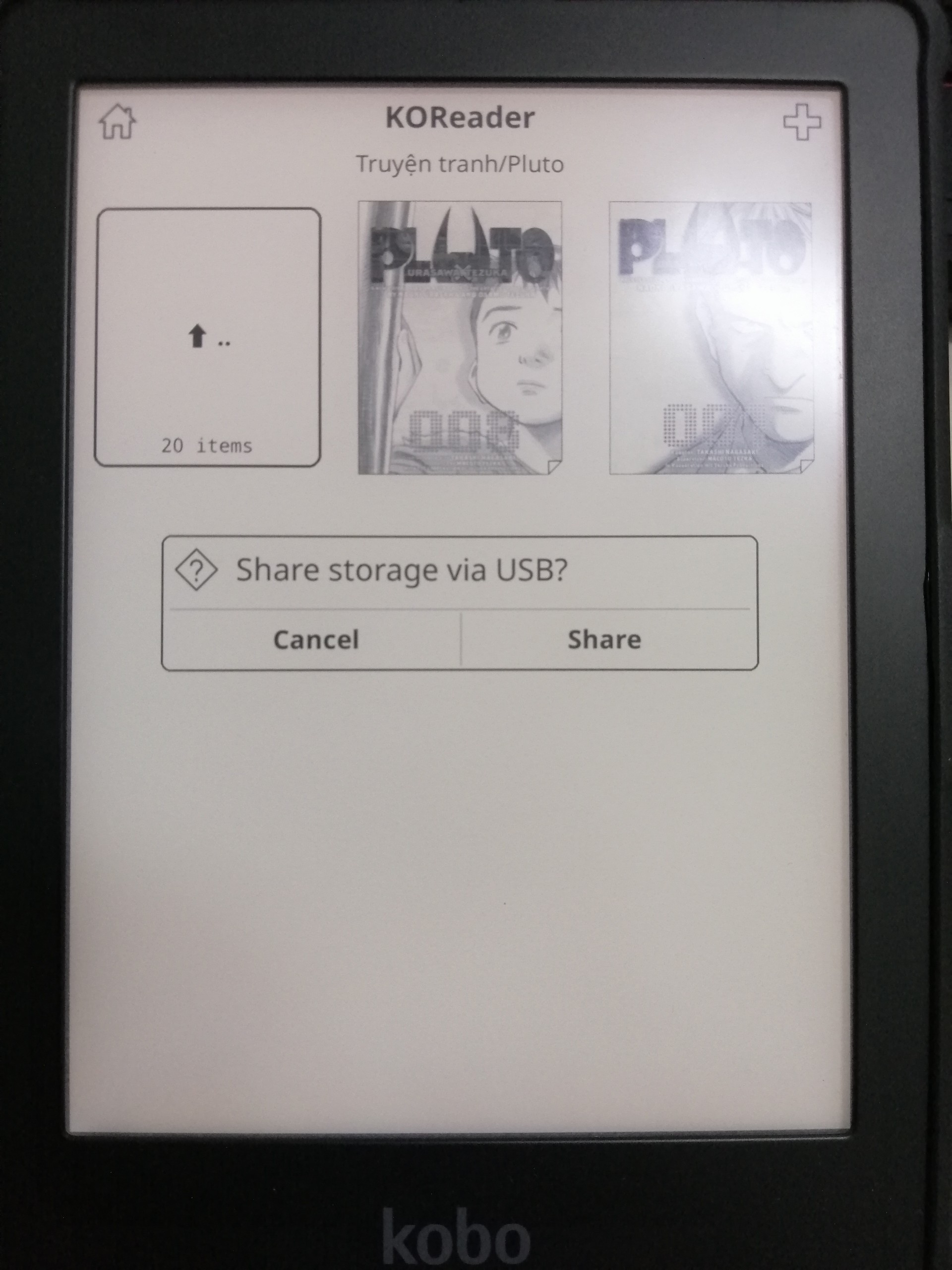

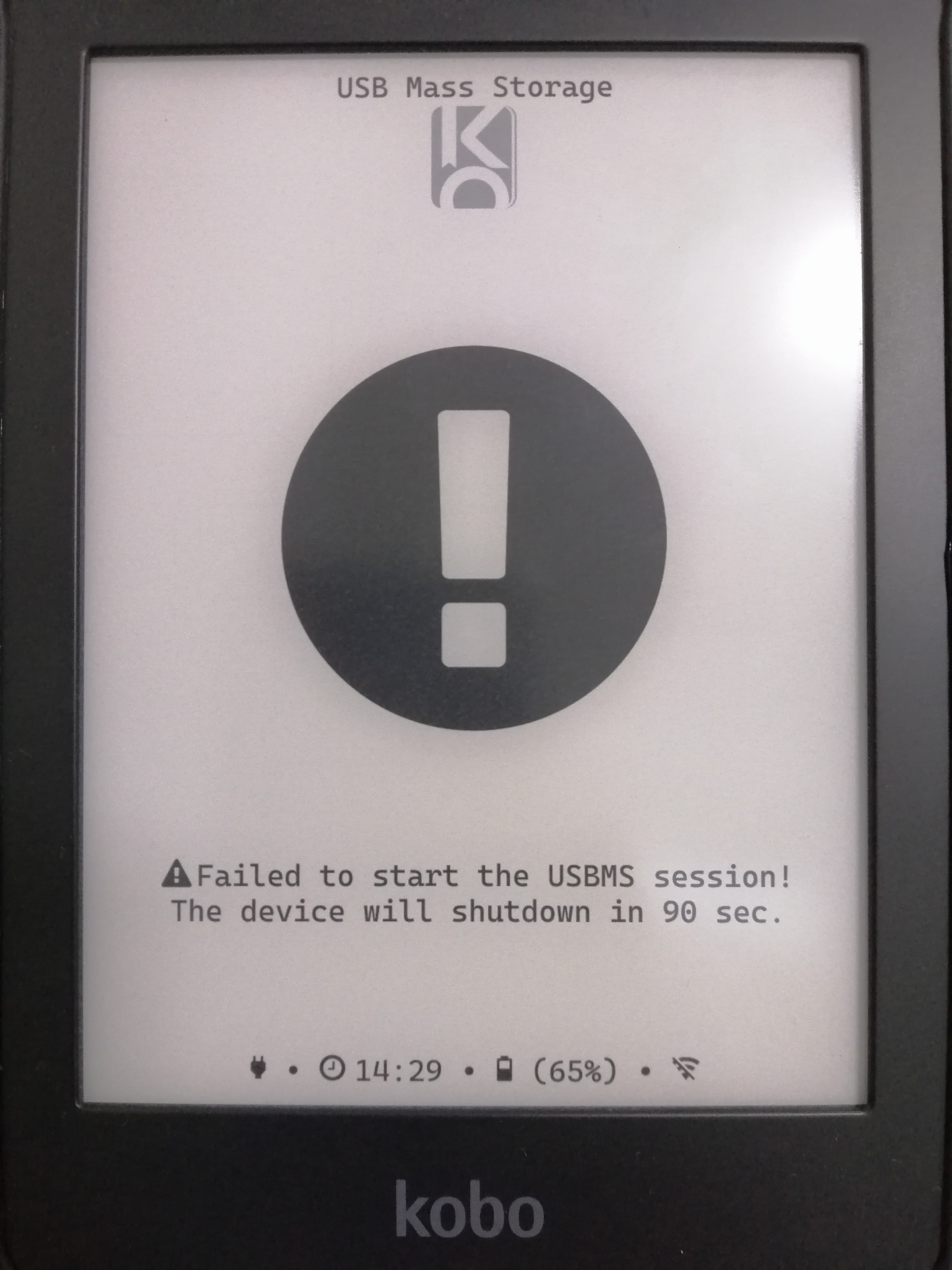

- When I connect my Kobo to PC while using Koreader it has an error. First it showed the crash screen but now it only shows the error screen like below. (I've already exited Koreader and restarted Kobo)

e.g., over SSH via Wi-Fi, run klogd, then do stuff for a while (you mentioned cbz, so, try paging a few times in one). Then start an USBMS session and let it fail, and *now* run logread and send me its output .

Hey here's my log:
Mar 5 18:04:07 dhcpcd-dbus: Got signal 15, exiting
Mar 5 18:04:07 dhcpcd[3006]: received signal TERM from PID 3341, stopping
Mar 5 18:04:07 dhcpcd[3006]: eth0: removing interface
Mar 5 18:04:07 dhcpcd[3006]: eth0: executing `/libexec/dhcpcd-run-hooks' STOPPED
Mar 5 18:04:07 dhcpcd[3006]: exited
Mar 5 18:09:57 usbms[3476]: Initializing USBMS v1.1.1 (2021-01-26 17:46:06 +0100)
Mar 5 18:09:57 usbms[3476]: [FBInk] Detected a Kobo Clara HD (376 => Nova @ Mark 7)
Mar 5 18:09:57 usbms[3476]: [FBInk] Enabled Kobo Mark 7 quirks
Mar 5 18:09:57 usbms[3476]: [FBInk] Clock tick frequency appears to be 100 Hz
Mar 5 18:09:57 usbms[3476]: [FBInk] Screen density set to 300 dpi
Mar 5 18:09:57 usbms[3476]: [FBInk] Variable fb info: 1072x1448, 8bpp @ rotation: 3 (Counter Clockwise, 270°)
Mar 5 18:09:57 usbms[3476]: [FBInk] Fixed fb info: ID is "mxc_epdc_fb", length of fb mem: 6782976 bytes & line length: 1088 bytes
Mar 5 18:09:57 usbms[3476]: [FBInk] Canonical rotation: 0 (Upright, 0°)
Mar 5 18:09:57 usbms[3476]: [FBInk] Fontsize set to 24x24 (IBM base glyph size: 8x8)
Mar 5 18:09:57 usbms[3476]: [FBInk] Line length: 44 cols, Page size: 60 rows
Mar 5 18:09:57 usbms[3476]: [FBInk] Vertical fit isn't perfect, shifting rows down by 4 pixels
Mar 5 18:09:57 usbms[3476]: [FBInk] Pen colors set to #000000 for the foreground and #FFFFFF for the background
Mar 5 18:09:57 usbms[3476]: Initialized FBInk v1.23.1-26-g4be8ead for Kobo
Mar 5 18:09:57 usbms[3476]: Initialized libue v1.4.0
Mar 5 18:09:57 usbms[3476]: Initialized libevdev v1.10.1 for device `gpio-keys`
Mar 5 18:09:57 usbms[3476]: [setup_usb_ids:118] USB product ID: 0x4228
Mar 5 18:09:57 usbms[3476]: [FBInk] Font `/mnt/usbms/resources/fonts/CaskaydiaCove_NF.otf` loaded for style 'Regular'
Mar 5 18:09:57 usbms[3476]: Internal storage partition wasn't busy, it's been successfully marked as expired.
Mar 5 18:09:57 usbms[3476]: Starting USBMS shenanigans
Mar 5 18:09:57 usbms[3476]: Checking charger type
Mar 5 18:09:57 usbms[3476]: SDP PC (Standard Downstream Port, 500mA) charger detected
Mar 5 18:09:57 usbms[3476]: Starting USBMS session...
Mar 5 18:09:57 usbms[3476]: [get_frontlight_intensity:273] sysfs says frontlight intensity is at 39%
Mar 5 18:09:57 usbms[3476]: Frontlight intensity is currently set to 39%
Mar 5 18:09:57 start-usbms.sh[3478]: Failed to unmount sd, aborting!
Mar 5 18:09:57 usbms[3476]: Failed to start the USBMS session (256)!
Mar 5 18:09:58 usbms[3476]: Bye!
Mar 5 18:09:58 koreader.sh[3327]: USBMS session failed (1), shutting down in 90 sec!
May be the problem is in "[3478]:Failed to unmount sd" ?
Ah, i've upgraded my storage to Sandisk 64gb Class 10, is that the cause?

It *shouldn't*, but who knows ^^. I'll look into it, thanks .
What I do know is that I don't actually use an SD card, so, having an SD card *period* was never really tested ^^.

Okay, I couldn't reproduce any issues with an SD card on my end,
but I did update the USBMS tool to be more user-friendly in case the SD card is busy, so, try again after replacing the tool with this one.
(Just replace the file in the koreader/data folder, don't unpack the archive or anything ).
Assuming something is actually holding on to the SD card, you'll get actionable feedback on-screen instead of a shutdown

Although, I suspect that all your troubles are related, and that it's simply one or more books that are tripping the thumbnail creation, so, I *also* wouldn't mind a look at verbose debug logs from KOReader .
(You can enable that from the file manager, Tools > More Tools > Developer tools. Restart KOReader after).

Another thing I would check is that the card is actually seated properly, and the filesystem sane.
e.g., power the device off, eject the card, insert it somewhere you can run a filesystem check on it, insert it back properly in the Kobo, power it back on.

Not unless that card itself has a defect.
