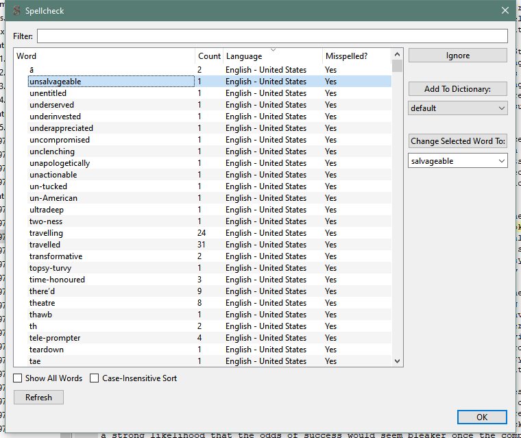

I have tried the Spellcheck option as suggested by Tex2002ans and I get the following result -
https://www.mobileread.com/forums/at...1&d=1610198353
The language has defaulted to US English (the book was published in the US) so it is now picking up words that I have already corrected to UK spelling as being misspelled.
I have tried clicking on the Language column to see if I can change it to UK English so that it spellchecks against the default UK dictionary, but there appears to no way to do that.
What am I missing?

How is Sigil to know a word is in British and not American?
If the main language is set to US, individual phrases in British must be clearly marked:
<span xml:lang="en-GB">colour</span>
Maybe it seems difficult, but if I have a whole book in Polish, and only a few dialogues in French, Italian or Spanish, it is obvious for me to mark the correct languages in these specific places. Then not only the spell check in Sigil works correctly, but also – what is equally important – appropriate readers can distinguish the language and for visually impaired people such expressions are read in correct languages by correct voices, and additionally words in foreign languages are hyphenated according to dictionaries assigned to these languages, not the main language in the e-book.
BeckyEbook is online now   Reply With Quote

Sorry Becky, I'm not sure I understand you.
The book was written with US spellings and all I want to do is spellcheck it against the default UK dictionary.
The spellcheck pop-up has spotted that it's a US book -as the language column has been set to that - so it's telling me that UK spellings are wrong.
All it appears to be doing at the moment is highlight words that it considers are misspelt in American and NOT those that are misspelt in UK English because it's checking against a US dictionary - which I don't have set as my default.
Oh, and the language in the opf is - <dc:language>en</dc:language>

In Sigil Preferences: set your Primary Spellcheck dictionary to English-Great Britain.
Then try spellchecking again. If there are still issues, then look for lang or xml:lang attributes set to en-US someplace in the html.

Thanks Kevin,
My default dictionary was already set to English - Great Britain, but your second suggestion was the problem as the headers all had lang="en-US" xml:lang="en-US in them.
I have removed the -US from them and Spellcheck now works as it should and only picks up UK misspelled words.
