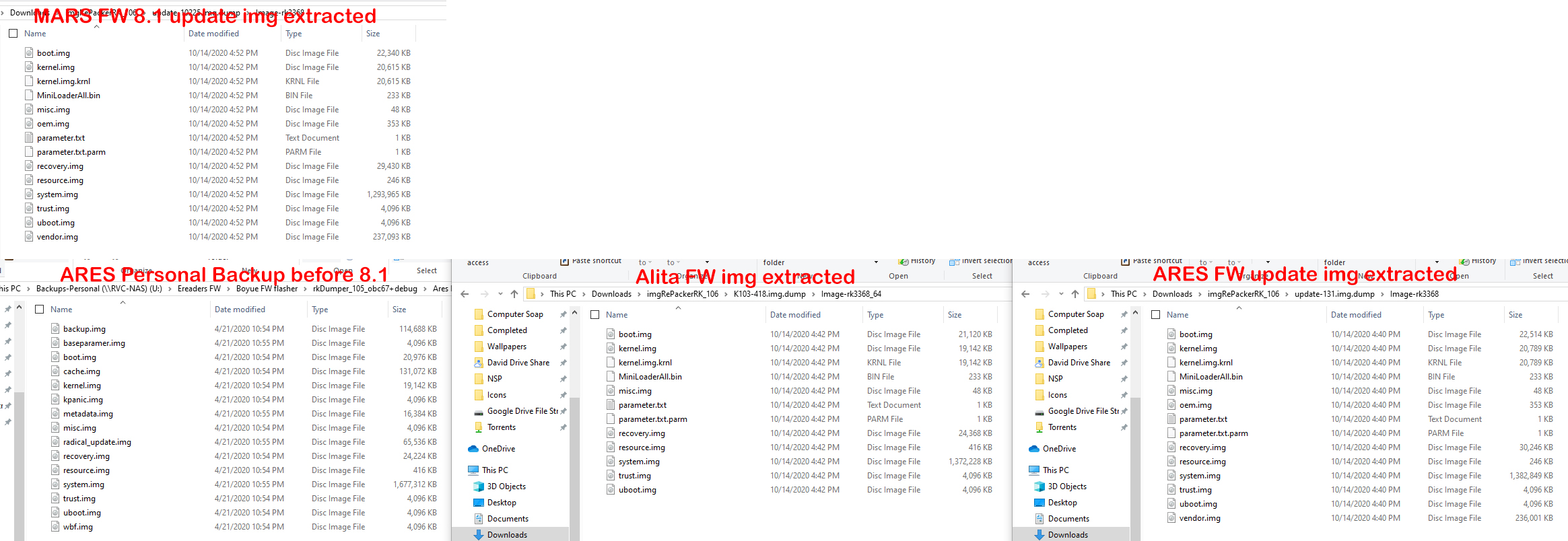

I looked at an old backup I have of the areas before the 8.1 update and also at the mars and alita and ares fw img extracted and I still have no idea what part is the thing flashing the Touch Panel alignment info into the devices, it would seem as if only the mars has this info added though and that's why once you flash that once in error the others don't seem to fix the issue on other devices. When flashing the ares FW it says it's erasing right?
Name:	FW ereaders.jpg
